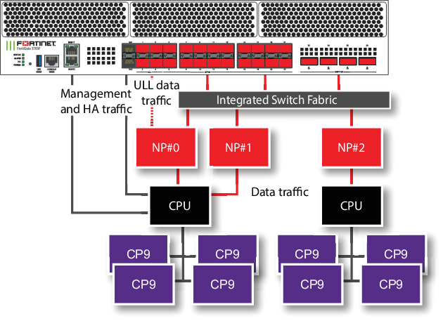

FortiGate 3700F and 3701F fast path architecture
The FortiGate 3700F and 3701F each include three NP7 processors. Front panel data interfaces 5 to 26 and the NP7 processors connect to the integrated switch fabric (ISF). All data traffic passes from the data interfaces through the ISF to the NP7 processors. Data traffic processed by the CPU takes a dedicated data path through the ISF and an NP7 processor to the CPU.
Front panel data interfaces 1 to 4 are connected directly to NP#0 (using the NP7 interface named NP#0-link1) instead of the ISF. Since the ISF introduces latency, interfaces 1 to 4 are ultra low latency interfaces (ULL), and NP7 traffic entering and exiting the FortiGate through these interfaces experiences lower latency than if it were passing through interfaces that are connected to the ISF. To achieve low latency, traffic must enter and exit the FortiGate through the 1 to 4 interfaces.
All supported traffic passing between any two data interfaces can be offloaded by the NP7 processors. This includes traffic passing between an interface connected to the ISF and a ULL interface. If traffic enters or exits through an interface connected to the ISF, it is subject to the latency resulting from passing through the ISF.
The FortiGate 3700F and 3701F models feature the following front panel interfaces:
  • Two 10G/5G/2.5G/1G/100M BASE-T RJ45 (MGMT1 and MGMT2, not connected to the NP7 processors).
  • Twenty 50/25/10/1 GigE SFP56 (HA1, HA2, 5 to 22) the HA interfaces are not connected to the NP7 processors).
  • Four 25/10 GigE SFP28/SFP+ (1 to 4) ultra low latency (ULL), all ULL interfaces operate at the same speed. ULL interfaces bypass the integrated switch fabric (ISF).
  • Four 400/200/100/40 GigE QSFP-DD (23 to 26). Each of these interfaces can be split into eight 50GigE interfaces, four 100GigE interfaces, or two 200 GigE interfaces.
The MGMT interfaces are not connected to the NP7 processors. Management traffic passes to the CPU over a dedicated management path that is separate from the data path. You can also dedicate separate CPU resources for management traffic to further isolate management processing from data processing (see Improving GUI and CLI responsiveness (dedicated management CPU)).
The HA interfaces are also not connected to the NP7 processors. To help provide better HA stability and resiliency, HA traffic uses a dedicated physical control path that provides HA control traffic separation from data traffic processing.
The separation of management and HA traffic from data traffic keeps management and HA traffic from affecting the stability and performance of data traffic processing.

The command output also shows the maximum and default speeds of each interface.
The integrated switch fabric distributes sessions from the data interfaces to the NP7 processors. The three NP7 processors have a bandwidth capacity of 200Gigabit x 3 = 600 Gigabit. If all interfaces were operating at their maximum bandwidth, the NP7 processors would not be able to offload all the traffic. You can use NPU port mapping to control how sessions are distributed to NP7 processors.
