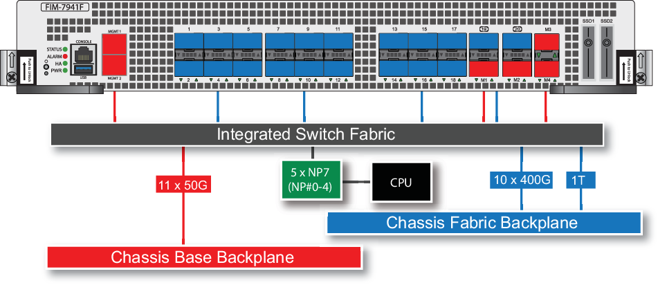

FIM-7941F fast path architecture
The FIM-7941F includes an integrated switch fabric (ISF) that connects the front panel interfaces and the chassis fabric backplane to the NP7 processors. The NP7 processors receive sessions from the FIM front panel data interfaces and the FPM front panel data interfaces over the fabric backplane. The NP7 processors use SLBC to distribute sessions to FPMs over the fabric backplane.
The FIM-7941F includes the following backplane communication channels:
- Ten 400Gbps fabric backplane channel to distribute traffic to the FPMs.
- Ten 50Gbps base backplane channel for base backplane communication with the FPMs.
- One 1Tbps fabric backplane channel for fabric backplane communication with the other FIM.
- One 50Gbps base backplane channel for base backplane communication with the other FIM.
The FIM-7941F features the following front panel interfaces:
- Two 10/100/1000BASE-T RJ45 (MGMT1 and MGMT2) base channel management interfaces.
- Eighteen 100/40 GigE QSFP28 (1 to 18) fabric channel data interfaces. Each of these interfaces can be split into four 25/10 GigE interfaces.
- Two 400/100/40 GigE QSFP-DD (19 and 20) fabric channel data interfaces. Each of these interfaces can be split into four 100/25/10GigE interfaces or eight 25/10 GigE interfaces.
- Two 100/40 GigE QSFP28 (M1 and M2) base channel management interfaces. Each of these interfaces can be split into four 25/10 GigE interfaces.
- Two 25/10 GigE SFP28 (M1 and M2 ) base channel management interfaces.
