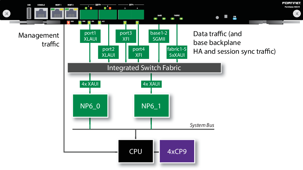

FortiGate-5001E and 5001E1 fast path architecture
The FortiGate 5001E and 5001E1 each include two NP6 processors. All front panel data interfaces and both of the NP6 processors connect to the integrated switch fabric (ISF). All data traffic passes from the data interfaces through the ISF to the NP6 processors. Because of the ISF, all supported traffic passing between any two data interfaces can be offloaded by the NP6 processors. No special mapping is required for fast path offloading or aggregate interfaces. Data traffic processed by the CPU takes a dedicated data path through the ISF and an NP6 processor to the CPU.
The FortiGate 5001E and 5001E1 models feature the following interfaces:

Two base backplane 1Gbps interfaces (base1 and base2) for HA heartbeat communications across the FortiGate-5000 chassis base backplane.
Five fabric backplane 40Gbps interfaces (fabric1 to fabric5) for data communications across the FortiGate-5000 chassis fabric backplane
You can use the following get command to display the FortiGate-5001E NP6 configuration. The command output shows both NP6s connected to each interface with cross-chip offloading supported for all interfaces connected to the NP6 processors. You can also use the diagnose npu np6 port-list command to display this information.

Distributing traffic evenly among the NP6 processors can optimize performance. For details, see Optimizing NP6 performance by distributing traffic to XAUI links.
You can also add LAGs to improve performance. For details, see Increasing NP6 offloading capacity using link aggregation groups (LAGs).
