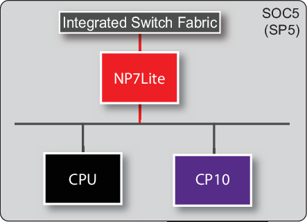

The NP7Lite processor is a component of the Fortinet SOC5 (also called the SP5). The SOC5 includes a CPU, the NP7Lite network processor, and a CP10 content processor.
The SOC5 also includes an integrated switch fabric (ISF) that connects all of the front panel network interfaces to the NP7Lite processor. The SOC5 ISF allows sessions passing between any FortiGate front panel interface pair to be offloaded by the NP7Lite processor. The SOC5 ISF also allows you to use the command config system virtual-switch to create a virtual hardware switch that can include any front panel interface connected to the SOC5.
To add an interface to a hardware switch, its mode must be set to static and the interface can't be used in any other configuration. For example, you can't have a firewall policy that references the interface.
SOC5 architecture
SOC5 architecture
