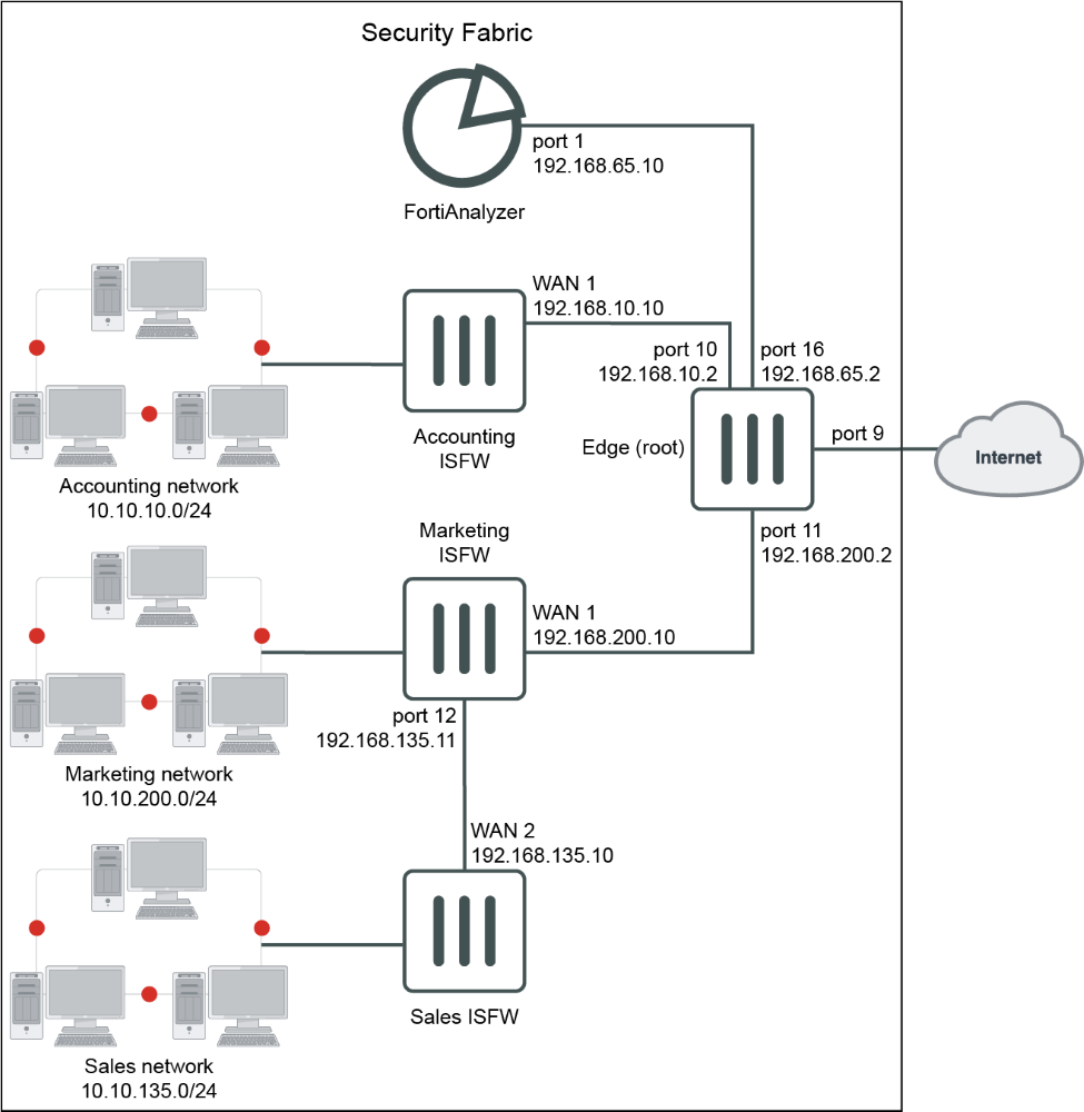

This topic provides an example of deploying Security Fabric with three downstream FortiGates connecting to one root FortiGate. To deploy Security Fabric, you need a FortiAnalyzer running firmware version 6.2 or later.
The following shows a sample network topology with three downstream FortiGates (Accounting, Marketing, and Sales) connected to the root FortiGate (Edge).

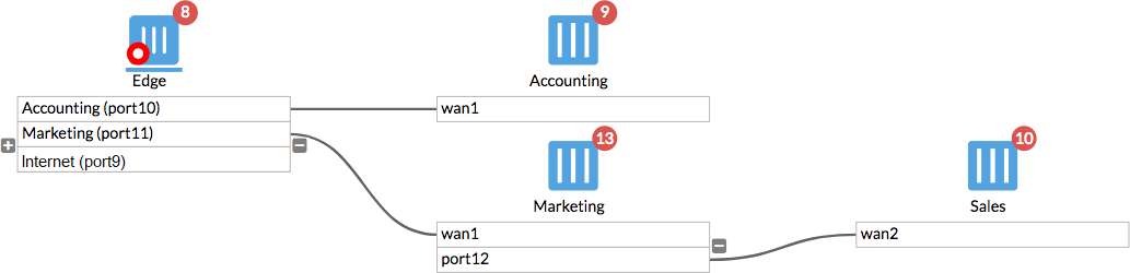

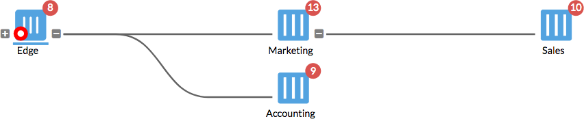

To authorize downstream FortiGates (Accounting, Marketing, and Sales) on the root FortiGate (Edge):
- In the root FortiGate (Edge), go to Security Fabric > Fabric Connectors and double-click the Security Fabric Setup card.
The Topology tree highlights two connected FortiGates with their serial numbers and asks you to authorize the highlighted devices.
- Select the highlighted FortiGates and select Authorize.
After they are authorized, the two downstream FortiGates (Accounting and Marketing) appear in the Topology tree in the Security Fabric > Fabric Connectors > Security Fabric Setup page. This means that the two downstream FortiGates (Accounting and Marketing) have successfully joined the Security Fabric.
- The Topology tree now highlights the FortiGate with the serial number that is connected to the downstream FortiGate (Marketing) and asks you to authorize the highlighted device.
After it is authorized, the downstream FortiGate ( Sales) appears in the Topology tree in the Security Fabric > Fabric Connectors > Security Fabric Setup page. This means that the downstream FortiGates (Sales) has successfully joined the Security Fabric.

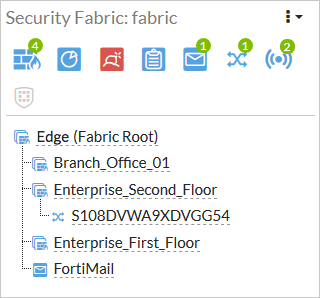

To check Security Fabric deployment result:
- On FortiGate (Edge), go to Dashboard > Status.
The Security Fabric widget displays all the FortiGates in the Security Fabric.
- On FortiGate (Edge), go to Security Fabric > Physical Topology.
This page shows a visualization of access layer devices in the Security Fabric.
This dashboard shows information about the interfaces of each device in the Security Fabric.
