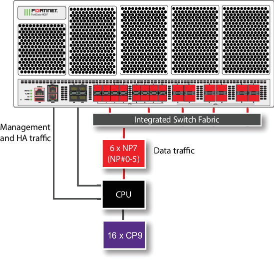

The FortiGate 4400F and 4401F each include six NP7 processors. All front panel data interfaces and the NP7 processors connect to the integrated switch fabric (ISF). All supported traffic passing between any two data interfaces can be offloaded by the NP7 processors. Because of the ISF, all data traffic passes from the data interfaces through the ISF to the NP7 processors. Data traffic processed by the CPU takes a dedicated data path through the ISF and an NP7 processor to the CPU.
The FortiGate 4400F and 4401F models feature the following front panel interfaces:
  • Two 1GigE RJ45 (MGMT1 and MGMT2, not connected to the NP7 processors).
  • Twenty 25/10/1 GigE SFP28 (HA1, HA2 , AUX1, AUX2, 1 to 16) HA1, HA2 , AUX1, AUX2 not connected to the NP7 processors. Interface groups: HA1, HA2, AUX1, and AUX2, 1 - 4, 5 - 8, 9 - 12, and 13 - 16. Every time you change the speed of one of these interfaces from 25Gbps to 10Gbps or 1Gbps or from 10Gbps or 1Gbps to 25Gbps the speeds of the other interfaces in the group also change to that speed. When you enter the end command, the CLI confirms the range of interfaces affected by the change.
  • Twelve 100/40 GigE QSFP28 (17 to 28). Each of these interfaces can be split into four 25/10/1 GigE SFP28 interfaces.
The MGMT interfaces are not connected to the NP7 processors. Management traffic passes to the CPU over a dedicated management path that is separate from the data path. You can also dedicate separate CPU resources for management traffic to further isolate management processing from data processing (see Improving GUI and CLI responsiveness (dedicated management CPU)).
The HA interfaces are also not connected to the NP7 processors. To help provide better HA stability and resiliency, HA traffic uses a dedicated physical control path that provides HA control traffic separation from data traffic processing.
The AUX interfaces are also not connected to the NP7 processors. Fortinet recommends using these interfaces for HA session synchronization.
The separation of management and HA traffic from data traffic keeps management and HA traffic from affecting the stability and performance of data traffic processing.

FortiGate 4400F and 4401F fast path architecture

port19   100000          100000           NP#0-5          0         67         ce9
port20   100000          100000           NP#0-5          0         61         ce8
port21   100000          100000           NP#0-5          0         75         ce11
port22   100000          100000           NP#0-5          0         71         ce10
port23   100000          100000           NP#0-5          0         83         ce13
port24   100000          100000           NP#0-5          0         79         ce12
port25   100000          100000           NP#0-5          0         91         ce15
port26   100000          100000           NP#0-5          0         87         ce14
port27   100000          100000           NP#0-5          0         99         ce17
port28   100000          100000           NP#0-5          0         95         ce16
NP Port:
Name   Switch_id SW_port_id SW_port_name
np0_0  0         5          ce0
np0_1  0         9          ce1
np1_0  0         13         ce2
np1_1  0         17         ce3
np2_0  0         21         ce4
np2_1  0         25         ce5
np3_0  0         115        ce21
np3_1  0         111        ce20
np4_0  0         107        ce19
np4_1  0         103        ce18
np5_0  0         123        ce23
np5_1  0         119        ce22
* Max_speed: Maximum speed, Dflt_speed: Default speed
* SW_port_id: Switch port ID, SW_port_name: Switch port name
The command output also shows the maximum and default speeds of each interface.
The integrated switch fabric distributes sessions from the data interfaces to the NP7 processors. The six NP7 processors have a bandwidth capacity of 200Gigabit x 6 = 1200 Gigabit. If all interfaces were operating at their maximum bandwidth, the NP7 processors would not be able to offload all the traffic. You can use NPU port mapping to control how sessions are distributed to NP7 processors.
You can add LAGs to improve performance. For details, see Increasing NP7 offloading capacity using link aggregation groups (LAGs).
The FortiGate-4400F and 4401F can be licensed for hyperscale firewall support, see the Hyperscale Firewall Guide.
Splitting the port17 to port28 interfaces
You can use the following command to split each FortiGate 4400F or 4401F 17 to 28 (port17 to port28) 100/40 GigE QSFP28 interface into four 25/10/1 GigE SFP28 interfaces. For example, to split interfaces 19 and 26 (port19 and port26), enter the following command:
config system global
set split-port port19 port26
The FortiGate 4400F or 4401F restarts and when it starts up:
  • The port19 interface has been replaced by four SFP28 interfaces named port19/1 to port19/4.
  • The port26 interface has been replaced by four SFP28 interfaces named port26/1 to port26/4.
A configuration change that causes a FortiGate to restart can disrupt the operation of an FGCP cluster. If possible, you should make this configuration change to the individual FortiGates before setting up the cluster. If the cluster is already operating, you should temporarily remove the secondary FortiGate(s) from the cluster, change the configuration of the individual FortiGates and then re-form the cluster. You can remove FortiGate(s) from a cluster using the Remove Device from HA cluster button on the System > HA GUI page. For more information, see Disconnecting a FortiGate.
By default, the speed of each split interface is set to 10000full (10GigE). These interfaces can operate as 25GigE, 10GigE, or 1GigE interfaces depending on the transceivers and breakout cables. You can use the config system interface command to change the speeds of the split interfaces.
If you set the speed of one of the split interfaces to 25000full (25GigE), all of the interfaces are changed to operate at this speed (no restart required). If the split interfaces are set to 25000full and you change the speed of one of them to 10000full (10GigE) they are all changed to 10000full (no restart required). When the interfaces are operating at 10000full, you can change the speeds of individual interfaces to operate at 1000full (1GigE).
Configuring FortiGate 4400F and 4401F NPU port mapping
The default FortiGate-4400F and 4401F port mapping configuration results in sessions passing from front panel data interfaces to the integrated switch fabric. The integrated switch fabric distributes these sessions among the NP7 processors. Each NP7 processor is connected to the switch fabric with a LAG that consists of two 100-Gigabit interfaces. The integrated switch fabric distributes sessions to the LAGs and each LAG distributes sessions between the two interfaces connected to the NP7 processor.
You can use NPU port mapping to override how data network interface sessions are distributed to NP7 processors. For example, you can set up NPU port mapping to send all traffic from a front panel data interface or LAG to a specific NP7 processor or group of NP7 processors, or a single NP7 link.
Use the following command to configure FortiGate 4400F and 4401F NPU port mapping:
config system npu-post
config port-npu-map
edit <interface-name>
set npu-group {All-NP | NP0 | NP1 | NP2 | NP3 | NP4 | NP5 | NP0-to-NP1 | NP2-to-NP3 | NP4-to-NP5 | NP0-to-NP3 | NP0-to-NP2 | NP3-to-NP5 | NP0-link0 | NP0-link1 | NP1-link0 | NP1-link1 | NP2-link0 | NP2-link1 | NP3-link0 | NP3-link1 | NP4-link0 | NP4-link1 | NP5-link0 | NP5-link1}
<interface-name> can be a physical interface or a LAG.
All-NP, (the default) distribute sessions among all six NP7 LAGs.
NP0, distribute sessions to the LAG connected to NP0.
NP1, distribute sessions to the LAG connected to NP1.
NP2, distribute sessions to the LAG connected to NP2.
NP3, distribute sessions to the LAG connected to NP3.
NP4, distribute sessions to the LAG connected to NP4.
NP5, distribute sessions to the LAG connected to NP5.
NP0-to-NP1, distribute sessions between the LAGs connected to NP0 and NP1.
NP2-to-NP3, distribute sessions between the LAGs connected to NP2 and NP3.
NP4-to-NP5, distribute sessions between the LAGs connected to NP4 and NP5.
NP0-to-NP3, distribute sessions among the LAGs connected to NP0, NP1, NP2, and NP3.
NP0-to-NP2, distribute sessions among the LAGs connected to NP0, NP1, and NP2.
NP3-to-NP5, distribute sessions among the LAGs connected to NP3, NP4, and NP5.
NP0-link0, send sessions from the front panel data interface to NP0 link 0.
NP0-link1, send sessions from the front panel data interface to NP0 link 1.
NP1-link0, send sessions from the front panel data interface toNP1 link 0.
NP1-link1, send sessions from the front panel data interface to NP1 link 1.
NP2-link0, send sessions from the front panel data interface to NP2 link 0.
NP2-link1, send sessions from the front panel data interface to NP2 link 1.
NP3-link0, send sessions from the front panel data interface to NP3 link 0.
NP3-link1, send sessions from the front panel data interface to NP3 link 1.
NP4-link0, send sessions from the front panel data interface to NP4 link 0.
NP4-link1, send sessions from the front panel data interface to NP4 link 1.
NP5-link0, send sessions from the front panel data interface to NP5 link 0.
NP5-link1, send sessions from the front panel data interface to NP5 link 1.
For example, use the following syntax to assign the FortiGate-4400F interfaces 25 and 26 to NP3, NP4 and NP5 and interfaces 27 and 28 to NP2 and NP5:
config system npu
config port-npu-map
edit port25
set npu-group NP3-to-NP5
edit port26
edit port27
set npu-group NP2 NP5
edit port28
While the FortiGate-4400F or 4401F is processing traffic, you can use the diagnose npu np7 cgmac-stats <npu-id> command to show how traffic is distributed to the NP7 links.
