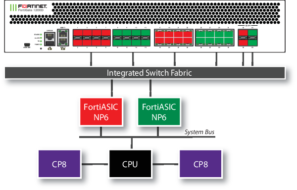

FortiGate 1200D fast path architecture
The FortiGate 1200D features two NP6 processors both connected to an integrated switch fabric.
- Eight SFP 1Gb interfaces (port1-port8), eight RJ-45 Ethernet ports (port17-24) and two SFP+ 10Gb interfaces (port33 and port34) share connections to the first NP6 processor.
- Eight SFP 1Gb interfaces (port9-port16), eight RJ-45 Ethernet ports (port25-32) and two SFP+ 10Gb interfaces (port35-port36) share connections to the second NP6 processor.
