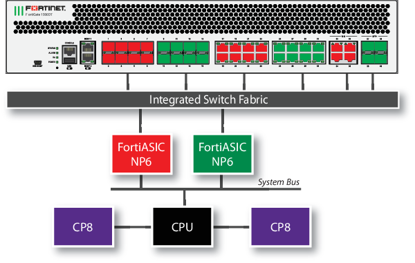

FortiGate 1500DT fast path architecture
The FortiGate 1500DT features two NP6 processors both connected to an integrated switch fabric. The FortiGate 1500DT has the same hardware configuration as the FortiGate 1500D, but with the addition of newer CPUs and a slightly different interface configuration.
The FortiGate 1500DT includes the following interfaces and NP6 processors:
- Eight SFP 1Gb interfaces (port1-port8), eight RJ-45 1Gb Ethernet interfaces (port17-24) and four RJ-45 10Gb Ethernet interfaces (port33-port36) share connections to the first NP6 processor.
- Eight SFP 1Gb interfaces (port9-port16), eight RJ-45 1Gb Ethernet ports (port25-32) and four SFP+ 10Gb interfaces (port37-port40) share connections to the second NP6 processor.
