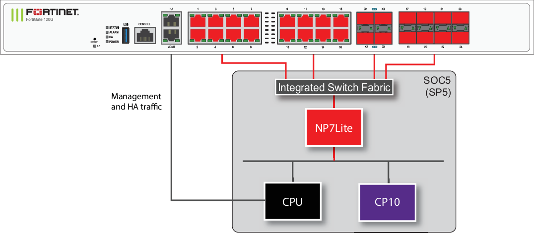

The FortiGate 120G and 121G includes the SOC5 (also called the SP5) and uses the SOC5 CPU, NP7Lite processor, and CP10 content processor. The SOC5 ISF connects all of the FortiGate 120G and 121G front panel data interfaces to the NP7Lite processor. The FortiGate 120G and 121G support DoS policy hardware acceleration, seeDoS policy hardware acceleration.
The FortiGate 120G and 121G features the following front panel interfaces:
  • Two 10/100/1000BASE-T Copper (HA, MGMT) connected to the SOC5 CPU.
  • Sixteen 10/100/1000BASE-T Copper (1 - 16) connected to the SOC5 integrated switch fabric.
  • Four 10 GigE SFP+ interfaces (X1 to X4) connected to the SOC5 integrated switch fabric. These are FortiLink interfaces.
  • Eight 1 GigE SFP (17 to 24) connected to the SOC5 integrated switch fabric.
The SOC5 includes an integrated switch fabric (ISF) that connects all of the front panel data interfaces to the NP7Lite processor. The SOC5 ISF allows sessions passing between any FortiGate front panel data interface pair to be offloaded by the NP7Lite processor. The SOC5 ISF also allows you to use the command config system virtual-switch to create a virtual hardware switch that can include any front panel interface connected to the SOC5.
To add an interface to a hardware switch, its mode must be set to static and the interface can't be used in any other configuration. For example, you can't have a firewall policy that references the interface.
The MGMT interface is not connected to the NP7Lite processor. Management traffic passes to the CPU over a dedicated management path that is separate from the data path. You can also dedicate separate CPU resources for management traffic to further isolate management processing from data processing (see Improving GUI and CLI responsiveness (dedicated management CPU)).
The HA interface is also not connected to the NP7Lite processor. To help provide better HA stability and resiliency, HA traffic uses a dedicated physical control path that provides HA control traffic separation from data traffic processing.
The separation of management and HA traffic from data traffic keeps management and HA traffic from affecting the stability and performance of data traffic processing.

FortiGate 120G and 121G fast path architecture
