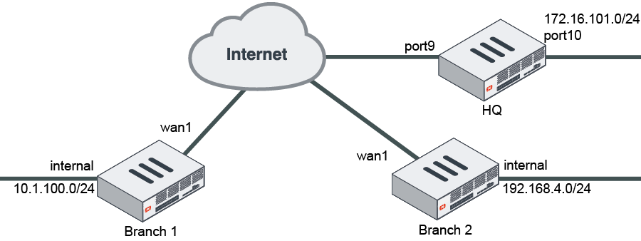

This is an example of policy-based IPsec tunnel using site-to-site VPN between branch and HQ. HQ is the IPsec concentrator.
Sample topology
Sample configuration

  1. Go to VPN > IPsec Concentrator and click Create New.
  2. Enter a name. In this example, branch.
  3. Add the Members to_branch1 and to_branch2.
  4. Click OK.
To configure the firewall policy at HQ:
  2. Enter a policy Name.
  3. For Incoming Interface, select port10.
  4. For Outgoing Interface, select port9.
  5. Select the Source, Destination, Schedule, Service, and set Action to IPsec.
  6. Select the VPN Tunnel, in this example, Branch1/Branch2.
  7. In this example, enable Allow traffic to be initiated from the remote site.
  8. Click OK.
To configure IPsec VPN at branch 1:
  1. Go to VPN > IPsec Wizard to set up branch 1.
  2. Enter a VPN name. In this example, to_HQ.
  3. For Template Type, click Custom. Click Next.
  4. Uncheck Enable IPsec Interface Mode.
  5. For Remote Gateway, select Static IP Address.
  6. Enter IP address, in this example, 22.1.1.1.
  7. For Interface, select wan1.
  8. In the Authentication section, for Method, select Pre-shared Key and enter the Pre-shared Key.
  9. Click OK.
To configure the firewall policy at branch 1:
  3. Choose the Incoming Interface, in this example, internal.
  4. Choose the Outgoing Interface, in this example, wan1.
  8. Click OK.
To configure IPsec VPN at branch 2:
  9. Click OK.
To configure the firewall policy at branch 2:
  6. Select the VPN Tunnel, in this example, to_HQ.
  8. Click OK.
