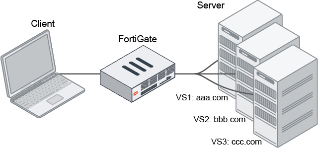

Multiple certificates can be defined in an SSL inspection profile in replace mode (Protecting SSL Server). This allows multiple sites to be deployed on the same protected server IP address, and inspection based on matching the SNI in the certificate.
When the FortiGate receives the client and server hello messages, it will compare the server name identification (SNI) and the common name (CN) with the certificate list in the SSL profile, and use the matched certificate as a replacement. If there is no matched server certificate in the list, then the first server certificate in the list is used as a replacement.

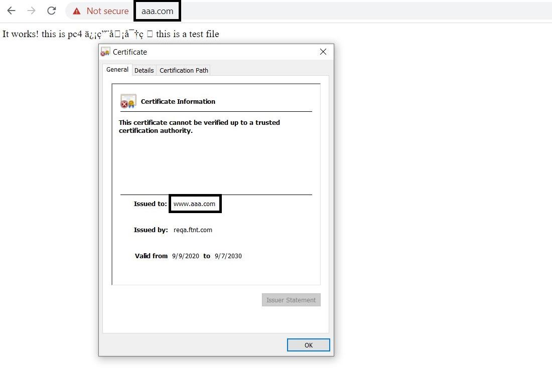

If the SNI matches the CN in the certificate list in the SSL profile, then the FortiGate uses the matched server certificate. In this example, when the client accesses www.aaa.com, the FortiGate will use the aaa certificate as a replacement.

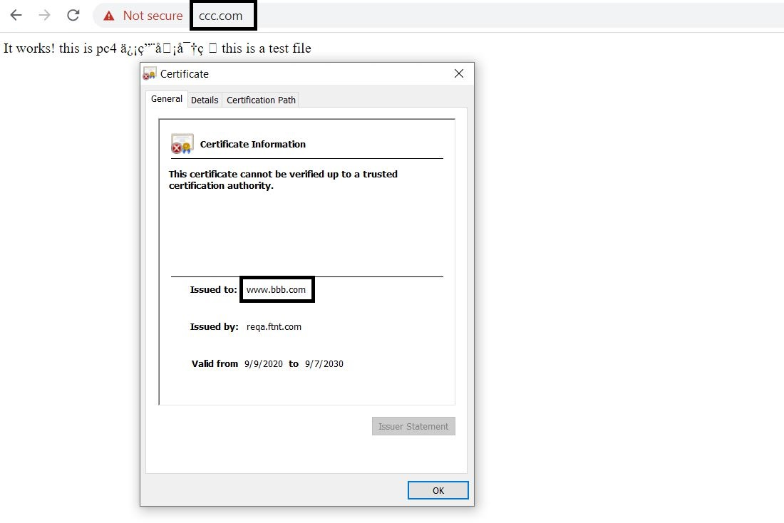

If the SNI does not match the CN in the certificate list in the SSL profile, then the FortiGate uses the first server certificate in the list. In this example, when the client accesses www.ccc.com, because there is no certificate for www.ccc.com, the FortiGate will use the bbb certificate as a replacement.
