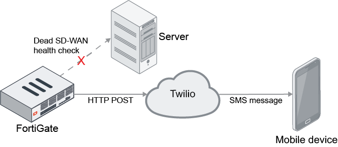

Example 1: using an SD-WAN heath check to trigger a Twilio webhook action
In this example, an administrator wants to monitor the FortiGate’s SD-WAN health, particularly when a dead health check is reported. An automation stitch will trigger the alert based on an SD-WAN log event (log ID 0113022931, SD-WAN SLA information warning) and perform a webhook action to inform Twilio to send an SMS message.

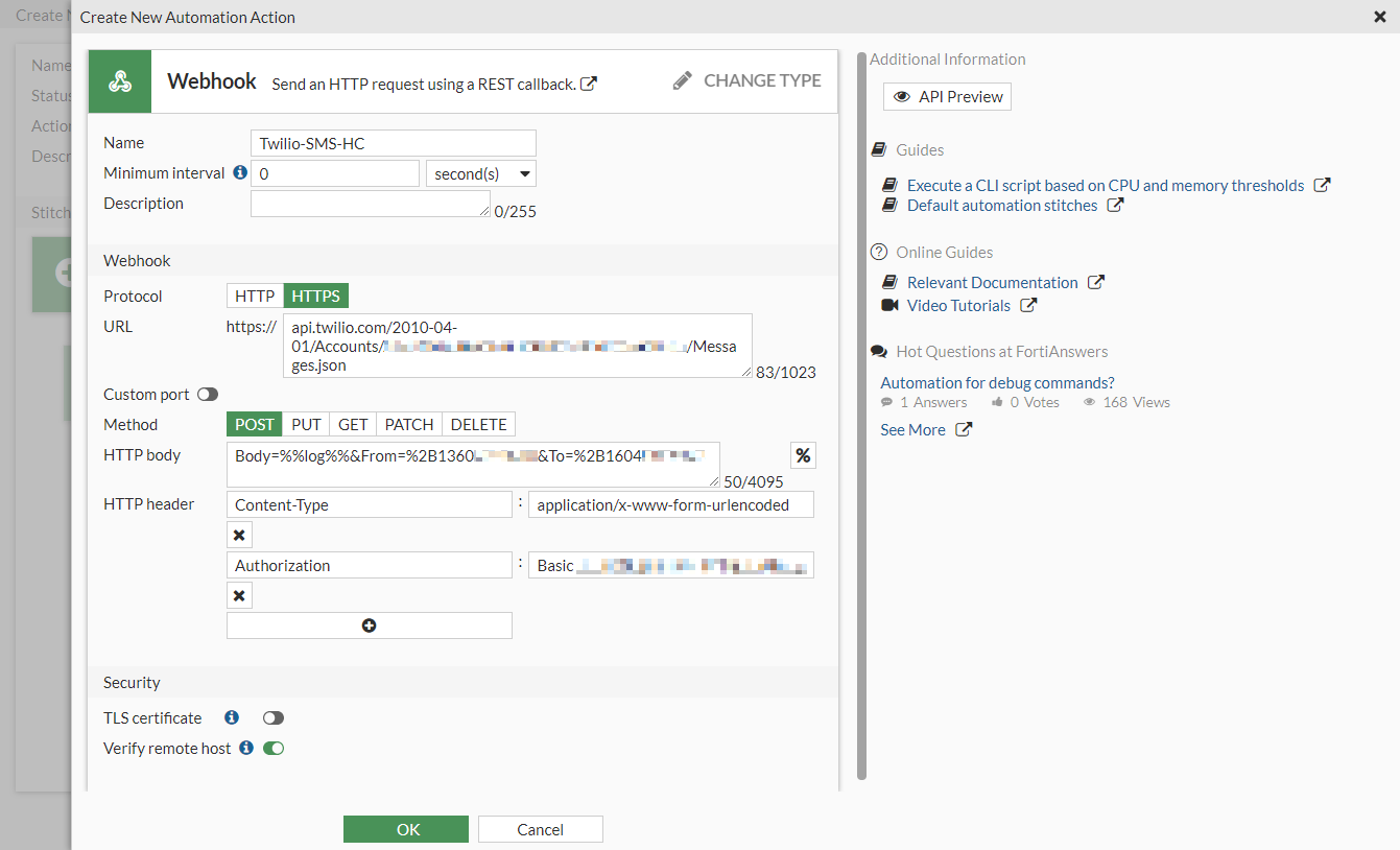

Configure the webhook action:
Click Add Action.
Click Create and select Webhook.
Enter the following:
Name
Twilio-SMS-HC
Protocol
HTTPS
URL
Enter the URL provided by Twilio for sending SMS messages using the POST method. The URL can be found in the cURL code sample in the following format: https://api.twilio.com/2010-04-01/Accounts/<Twilio _Account_SID>/Messages.json.
Method
POST
HTTP body
Body=%%log%%&From=%2B1360x*******&To=%2B1604*******
This string for the body text includes the SD-WAN log message, and the Twilio from and to phone numbers.
HTTP header
Content-Type : application/x-www-form-urlencoded
Authorization : Basic <Base64_encoded_authentication_code>
Click OK.
Select the action in the list and click Apply.

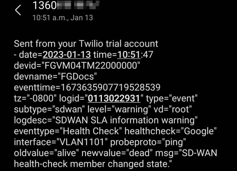

Verification:
Simulate an SD-WAN health check failure to trigger the automation stitch.
Twilio sends an SMS message to the administrator.
Go to Security Fabric > Automation and locate the SD-WAN-HC-Down-SMS stitch. The Trigger Count value has increased by one.
System log after the stitch was triggered:
date=2023-01-13 time=10:51:47 eventtime=1673635907720476287 tz="-0800" logid="0100046600" type="event" subtype="system" level="notice" vd="root" logdesc="Automation stitch triggered" stitch="SD-WAN-HC-Down-SMS" trigger="SD-WAN-HC-Down" stitchaction="Twilio-SMS-HC" from="log" msg="stitch:SD-WAN-HC-Down-SMS is triggered."

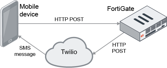

Example 2: using an incoming webhook to trigger a Twilio webhook action
In this example, an administrator wants to trigger an automation stitch remotely to retrieve the device uptime with an SMS text message. An incoming webhook will be used to send an HTTP POST request to trigger the event to occur. Subsequently, the FortiGate performs a CLI action followed by a webhook action to inform Twilio to send an SMS text message.

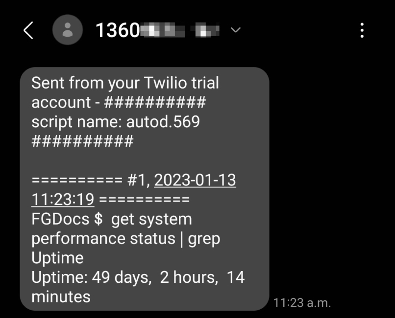

Verification:
From a command prompt, issue the sample cURL command as recommended by the Check-Uptime-Webhook incoming webhook:
>curl -k -X POST -H "Authorization: Bearer <API_token>" --data "{ 'srcip': '1.1.1.1', 'mac':'11:11:11:11:11:11', 'fctuid': '********************************'}" https://x.x.x.x/api/v2/monitor/system/automation-stitch/webhook/Check-Uptime-WebhookResponse:
{ "http_method":"POST", "status":"success", "http_status":200, "serial":"FGVM04TM20000000", "version":"v7.0.10", "build":0450 } -
This triggers the automation stitch on the FortiGate to send a HTTP POST request to Twilio. In response, Twilio sends an SMS text message to the recipient.

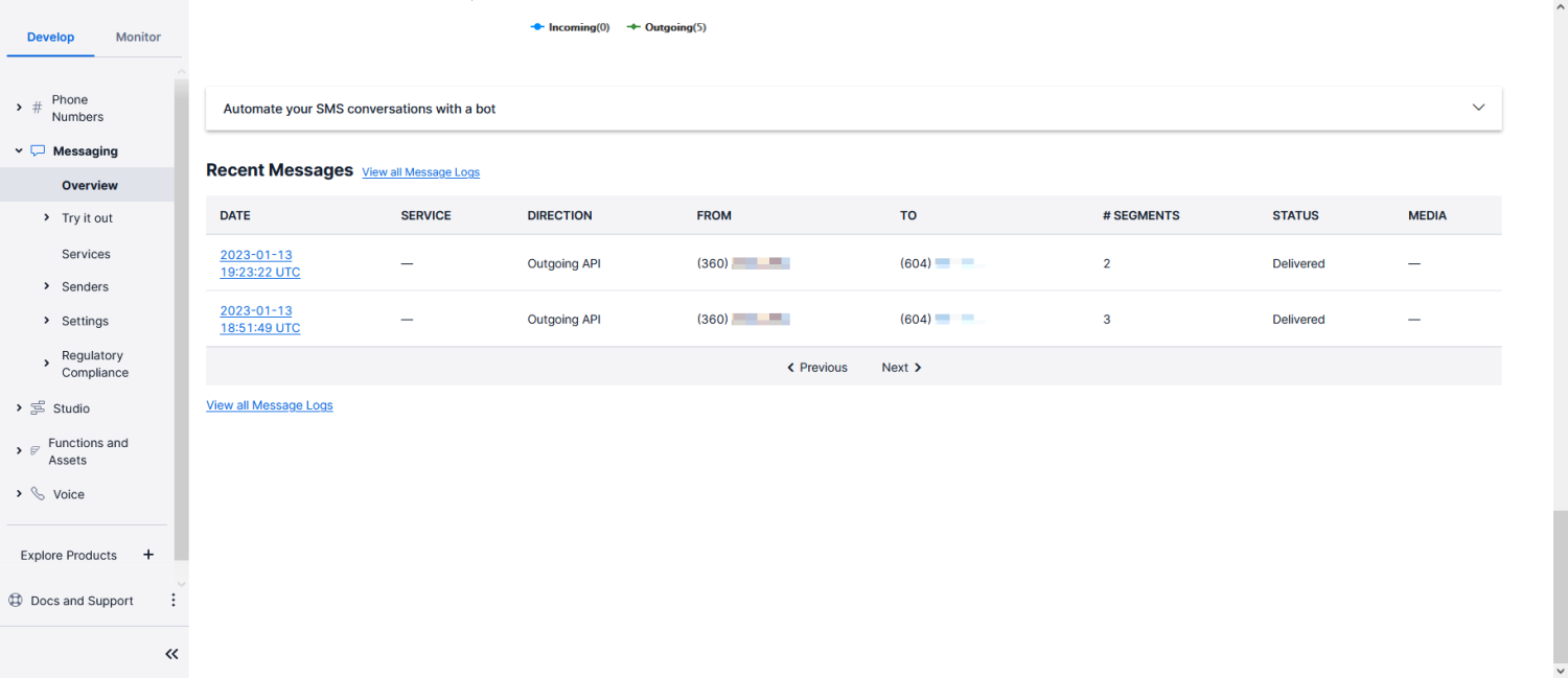

From the Twilio dashboard, go to Messaging > Overview and verify the Recent Messages section to confirm that the SMS text message was delivered.
