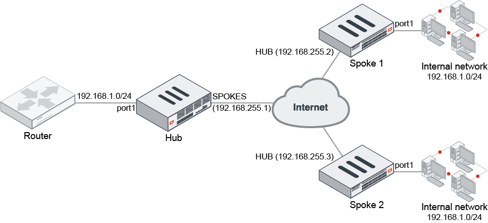

This example describes how to implement VXLAN over IPsec VPN using a VXLAN tunnel endpoint (VTEP).
This example uses a hub and spoke topology. Dialup VPN is used because it allows a single phase 1 dialup definition on the hub FortiGate. Additional spoke tunnels are added with minimal changes to the hub by adding a user account and VXLAN interface for each spoke. Spoke-to-spoke communication is established through the hub. This example assumes that the authentication users and user groups have already been created. While this topology demonstrates hub and spoke with dialup tunnels with XAuth authentication, the same logic can be applied to a static VPN with or without XAuth.
IPsec tunnel interfaces are used to support VXLAN tunnel termination. An IP address is set for each tunnel interface. Ping access is allowed for troubleshooting purposes.
VTEPs are created on the hub and each spoke to forward VXLAN traffic through the IPsec tunnels. VXLAN encapsulates OSI layer 2 Ethernet frames within layer 3 IP packets. You will need to either combine the internal port1 and VXLAN interface into a soft switch, or create a virtual wire pair so that devices behind port1 have direct layer 2 access to remote peers over the VXLAN tunnel. This example uses a switch interface on the hub and a virtual wire pair on the spokes to demonstrate the two different methods.
In order to apply an IPsec VPN interface on the VXLAN interface setting, net-device must be disabled in the IPsec VPN phase 1 settings.

To bind the VXLAN interface to the internal interface:
- Configure a switch interface on the hub:
config system switch-interface edit "SW" set vdom "root" set member "port1" "SPOKES_VXLAN1" "SPOKES_VXLAN2" set intra-switch-policy {implicit | explicit} next end
Allowing intra-switch traffic is implicitly allowed by default. Use
set intra-switch-policy explicitto require firewall policies to allow traffic between switch interfaces. - Configure a virtual wire pair on the spokes:
config system virtual-wire-pair edit "VWP" set member "HUB_VXLAN" "port1" next end
The virtual wire pair requires an explicit policy to allow traffic between interfaces.
