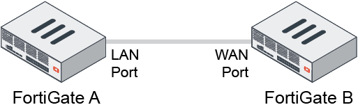

When a FortiGate B's WAN interface detects that FortiGate A's LAN interface is immediately upstream (through the default gateway), and FortiGate A has Security Fabric enabled, FortiGate B will show a notification on the GUI asking to join the Security Fabric.

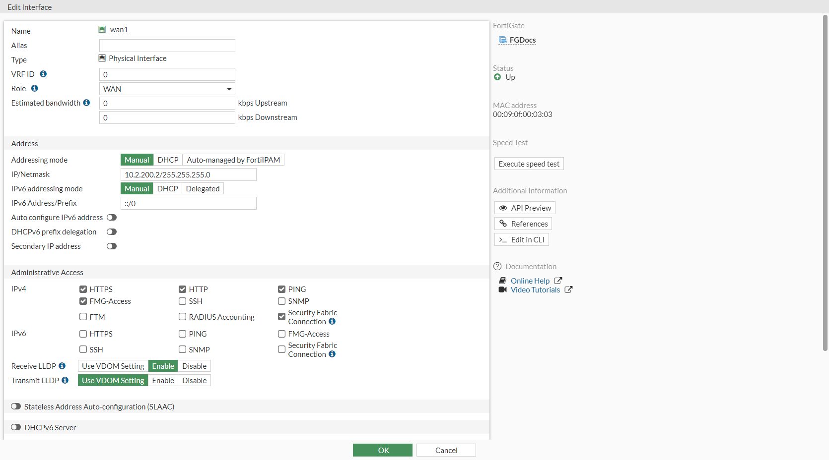

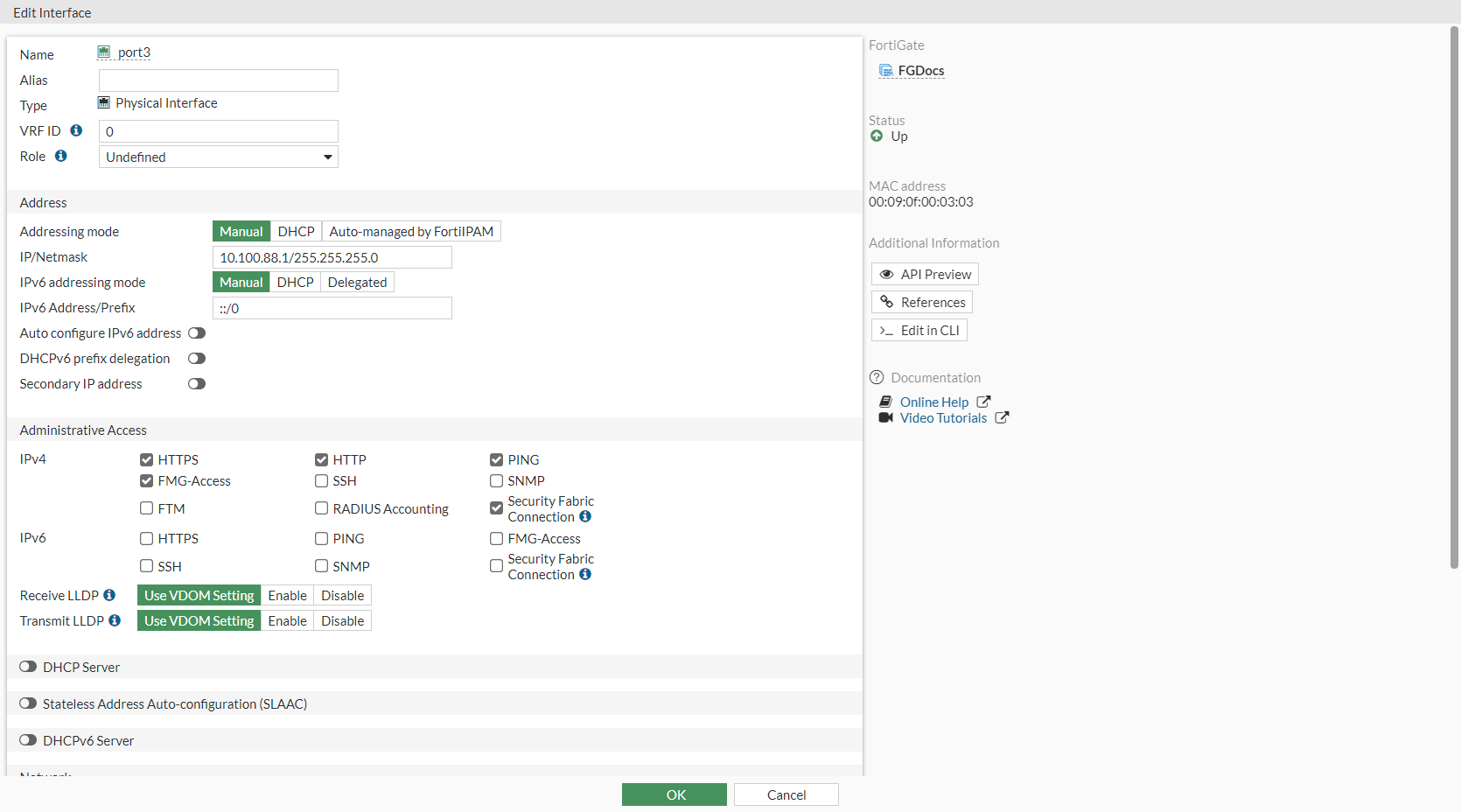

- If the interface's role is undefined, under Administrative Access, set Receive LLDP and Transmit LLDP to Use VDOM Setting.
- If the interface's role is WAN, under Administrative Access, set Receive LLDP to Enable and Transmit LLDP to Use VDOM Setting.

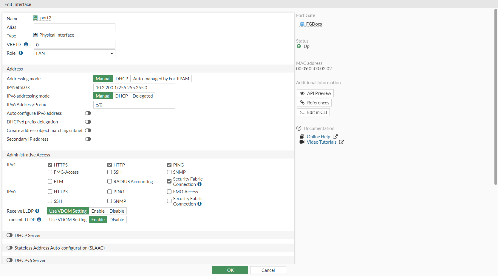

- If the interface's role is LAN, under Administrative Access, set Receive LLDP to Use VDOM Setting and Transmit LLDP to Enable.

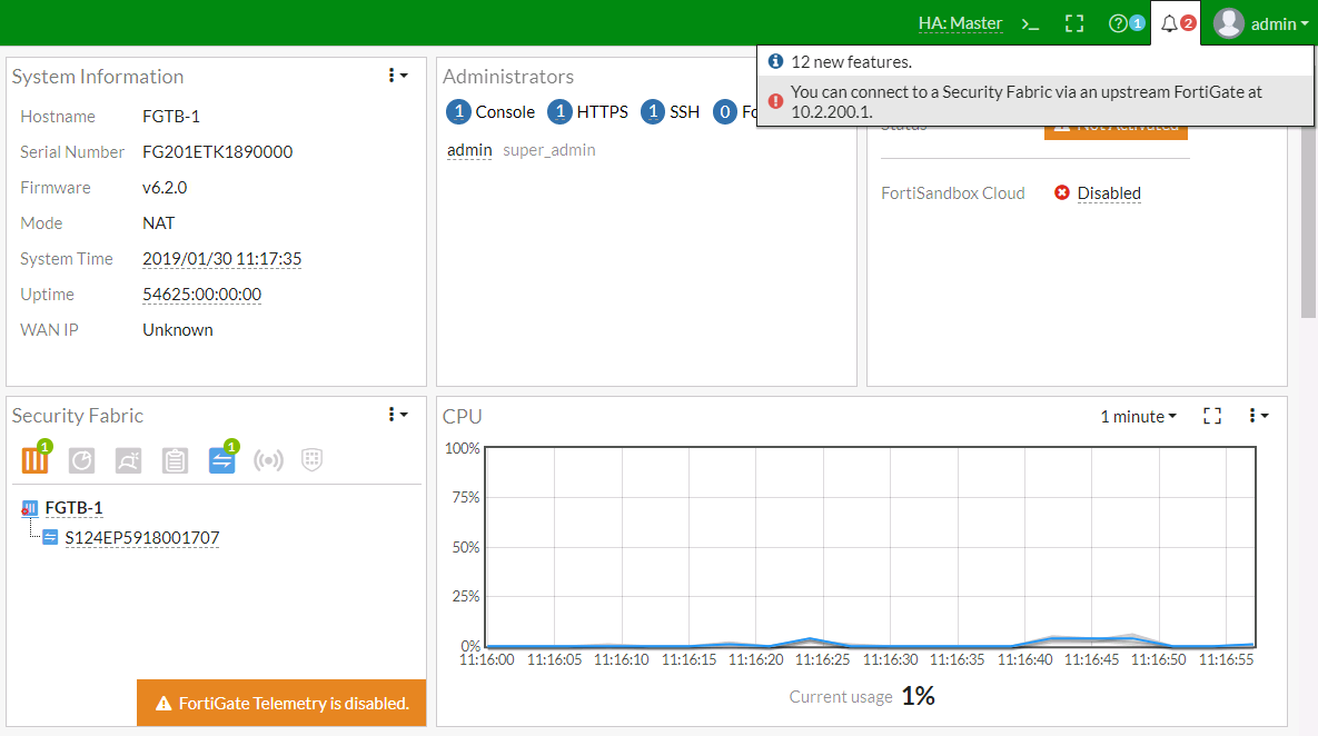

- Click OK. A notification is shown on FortiGate B, You can connect to a Security Fabric via an upstream FortiGate at 10.2.200.1.
- Click the notification. The Core Network Security page with the Security Fabric settings opens. All the required settings automatically configured.
- Click OK to apply the settings.
