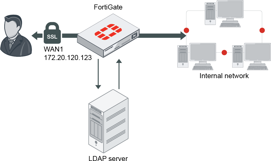

This is a sample configuration of SSL VPN for LDAP users. In this example, the LDAP server is a Windows 2012 AD server. A user ldu1 is configured on Windows 2012 AD server.
You must have generated and exported a CA certificate from the AD server and then have imported it as an external CA certificate into the FortiGate.
Sample topology
Sample configuration
WAN interface is the interface connected to ISP. This example shows static mode. You can also use DHCP or PPPoE mode. The SSL VPN connection is established over the WAN interface.
