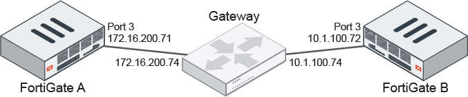

Unicast standalone configuration synchronization is supported on layer 3, allowing peers to be synchronized in cloud environments that do not support layer 2 networking. Configuring a unicast gateway allows peers to be in different subnets.
Example
In this example, two FortiGates in different subnets are connected through a unicast gateway. Both cluster members use the same port for the heartbeat interface.
To configure unicast synchronization between peers:
Configure FortiGate A:
config system ha set group-name "testcs" set hbdev "port3" 50 set standalone-config-sync enable set unicast-status enable config unicast-peers edit 1 set peer-ip 10.1.100.72 next end set override enable set priority 200 set unicast-gateway 172.16.200.74 end -
Configure FortiGate B:
config system ha set group-name "testcs" set hbdev "port3" 50 set standalone-config-sync enable set unicast-status enable config unicast-peers edit 1 set peer-ip 172.16.200.71 next end set override enable set priority 100 set unicast-gateway 10.1.100.74 end -
