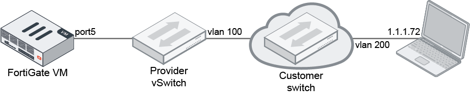

QinQ (802.1Q in 802.1Q) is supported for FortiGate VM models, where multiple VLAN tags can be inserted into a single frame.
In this example, the FortiGate VM is connected to a provider vSwitch and then a customer switch. The FortiGate encapsulates the frame with an outer 802.1Q tag of VLAN 100 and an inner 802.1Q tag of VLAN 200; port5 is used as the physical port. The provider vSwitch strips the outer tag and forwards traffic to the appropriate customer. Then the customer switch strips the inner tag and forwards the packet to the appropriate customer VLAN.

    The outer tag (first tag) is an 802.1Q tag with VLAN ID 100. The inner tag (second tag) is also an 802.1Q tag with VLAN ID 200.
