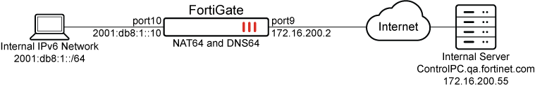

Sample topology
In this example, a host on the internal IPv6 network communicates with ControlPC.qa.fortinet.com that only has IPv4 address on the Internet. Central NAT is disabled.
The host on the internal network does a DNS lookup for
ControlPC.qa.fortinet.comby sending a DNS query for an AAAA record forControlPC.qa.fortinet.com. -
The DNS query is intercepted by the FortiGate DNS proxy. The DNS proxy performs an A-record query for
ControlPC.qa.fortinet.comand gets back an RRSet containing a single A record with the IPv4 address172.16.200.55. -
The DNS proxy then synthesizes an AAAA record. The IPv6 address in the AAAA record begins with the configured NAT64 prefix in the upper 96 bits and the received IPv4 address in the lower 32 bits. By default, the resulting IPv6 address is
64:ff9b::172.16.200.55. -
The host on the internal network receives the synthetic AAAA record and sends a packet to the destination address
The packet is routed to the FortiGate internal interface (port10) where it is accepted by the NAT64 security policy.
The FortiGate translates the destination address of the packets from IPv6 address
64:ff9b::172.16.200.55to IPv4 address172.16.200.55and translates the source address of the packets to172.16.200.200(or another address in the IP pool range) and forwards the packets out the port9 interface to the Internet.
