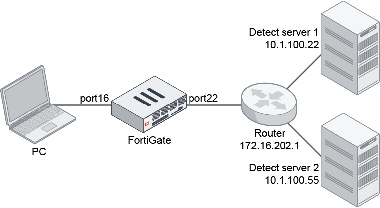

In the following topology, there are two detect servers that connect to the FortiGate through a router: server 1 (10.1.100.22) and server 2 (10.1.100.55).
Alive link health monitor
In this configuration, one server is dead and one server alive. The failed server weight is not over the threshold, so the link health monitor status is alive.
