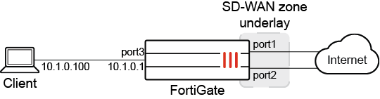

In this example, users are managed through Microsoft Entra ID (formerly Azure Active Directory). The FortiGate is configured for SSO firewall authentication for outbound traffic, with authentication performed by the Microsoft Entra ID as a SAML identity provider (IdP).

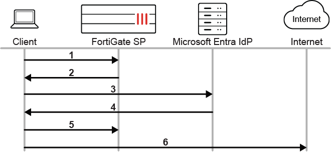

The SAML interaction occurs as follows:
  1. The user initiates web traffic to the internet.
  2. The FortiGate redirects to the local captive portal port (default is 1003), then redirects the user to the SAML IdP.
  3. The user connects to the Microsoft log in page for the SAML authentication request.
  4. The SAML IdP sends the SAML assertion containing the user and group.
  5. The browser forwards the SAML assertion to the SAML SP.
  6. If the user and group are allowed by the FortiGate, the user is allowed to access the internet.
In this example environment, a user is added in the Microsoft Entra ID belonging to the security group called Firewall.
  • Username: John Locus
  • User login: jlocus@azure.kldocs.com

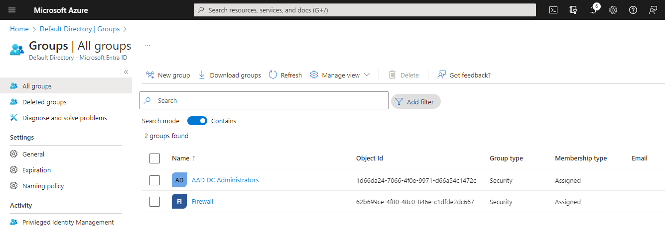

  • Group: Firewall (ID 62b699ce-4f80-48c0-846e-c1dfde2dc667)
The goal is to allow users in the Firewall group to access the internet after passing firewall authentication.

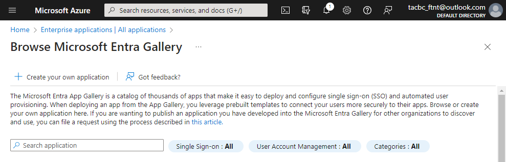

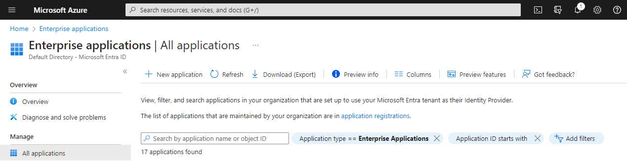

To create a new enterprise application:
  1. Log in to the Azure portal.
  2. In the Azure portal menu, click Microsoft Entra ID.
  3. In the left-side menu go Manage > Enterprise applications.
  4. Click New application.

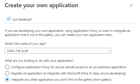

  5. Click Create your own application.
  6. Enter a name for the application (SAML-FW-Auth) and select Integrate any other application you don't find in the gallery (Non-gallery).
  7. Click Create.

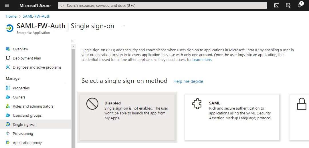

  1. On the Overview page for your new application, go to Manage > Single sign-on and select SAML as the single sign-on method.
  2. The Basic SAML Configuration section in Azure describes the SAML SP entity and links that Azure will reference. Configure these settings on the FortiGate by creating a new SAML server object and defining the SP address. The SP (IP or FQDN) address should be accessible by the user who is authenticating against the firewall. The port used should match the port used by the FortiGate firewall authentication captive portal. By default, this is port 1003 for HTTPS. A captive portal does not need to be configured separately.

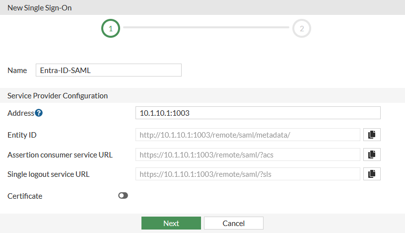

    1. Go to User & Authentication > Single Sign-On and click Create New.
    2. Enter a Name for the SAML object, Entra-ID-SAML.
    3. Enter the SP address, 10.1.0.1:1003. The three SP URLs are automatically populated.

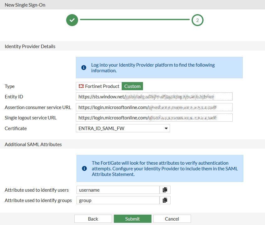

  7. In the Set up <application name> section, copy the URLs from Azure to the FortiGate in the IdP Details section:
    1. On the FortiGate, click Next.
    2. For IdP type, select Custom and copy the following from Azure to the corresponding field:
      From Azure
      To FortiGate field
      Microsoft Entra Identifier
      Entity ID
      Login URL
      Assertion consumer service URL
      Logout URL
      Single logout service URL
    3. For Certificate, select the remote certificate imported earlier.

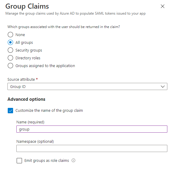

  8. In Azure, edit the User Attributes & Claims section. The attributes are returned in the SAML assertion, which the FortiGate uses to verify the user and group. Configuring group matching is optional.
    1. Click Add new claim, name it username, and set the Source attribute to user.displayname. The source attribute can be any of the related username fields. The value of the username returned to the FortiGate will be used in logs and monitors to identify the user.
    2. Click Save.
    3. Click Add a group claim and in the Group Claims pane, select All groups.
    4. In Advanced Options, select Customize the name of the group claim. Set the name to group.
    5. Click Save. The User Attributes & Claims section displays the update settings.
  9. On the FortiGate, update the Additional SAML Attributes section with the username and group created in Azure:
    1. For Attribute used to identify users, enter username.
    2. For Attribute used to identify groups, enter group.
    3. Click Submit.

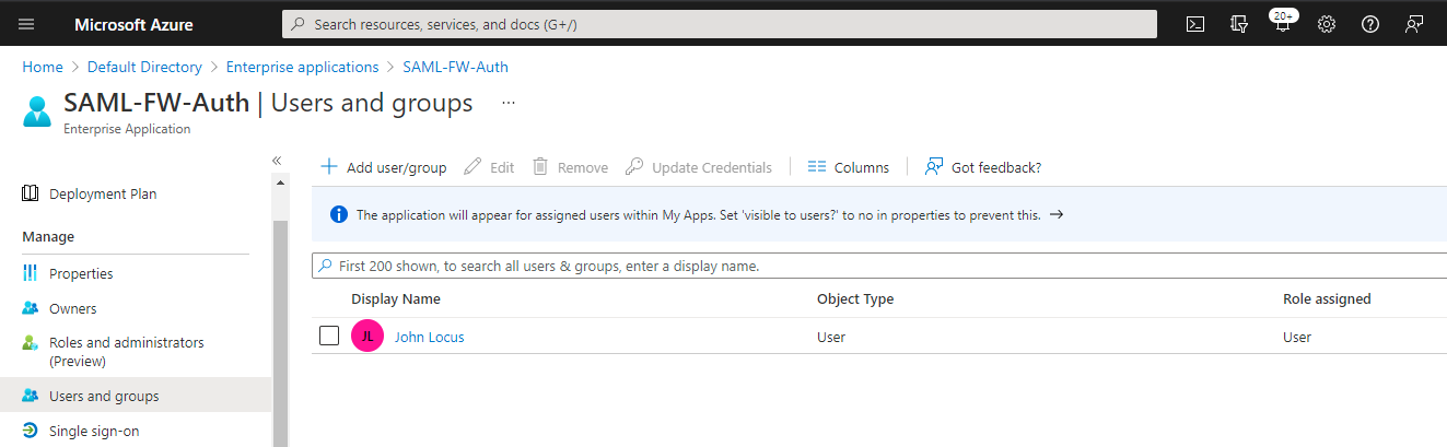

To assign Microsoft Entra users and groups to the application:
  1. In Azure, go to the application's Overview page.
  2. Go to Manage > Users and groups and click Add user/group.
  3. Click Users to select the users or groups (John Locus is selected in this example).
  4. Click Assign to add the assignment.

Configuring group matching is optional, and the Object ID from Azure is needed for the config match settings. In the Azure default directory, go to Manage > Groups and locate the Object ID for the Firewall group.
To configure the user group:
config user group
    edit "Azure-FW-Auth"
        set member "Entra-ID-SAML"
        config match
                set server-name "Entra-ID-SAML"
                set group-name "62b699ce-4f80-48c0-846e-c1dfde2dc667"

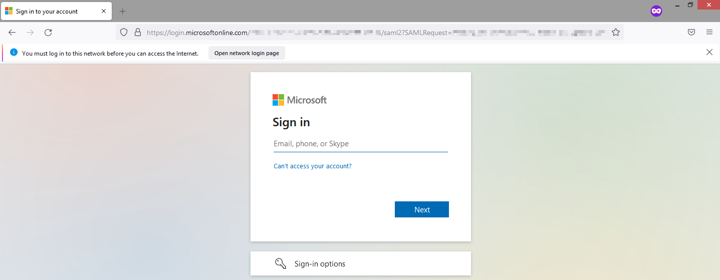

When the client connects to the internet from a browser, they will be redirected to the Microsoft log in page to authenticate against the Microsoft Entra ID. The FortiGate’s authentication portal certificate should be installed on the client.
To connect from the client:
  1. On the client, open a browser (such as Firefox) and go to a website. The user is redirected to the Microsoft log in page.
  2. Enter the user credentials.
  3. If the log in attempt is successful, the user is allowed to access the internet

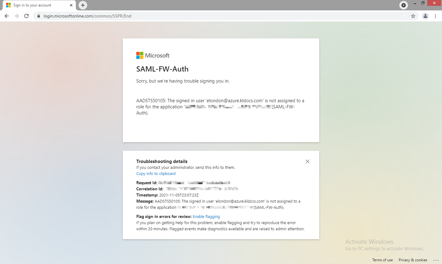

If a user receives the following error message, this means the user is not assigned to the enterprise application SAML-FW-Auth in Azure.

  7. Click Create.
  3. In Azure on the Set up Single Sign-On with SAML page, copy the following URLs from the FortiGate to the Basic SAML Configuration section:
      From Azure
      To FortiGate field
      Entity ID
      Login URL
      Logout URL
    2. Click Save.
    3. Click Submit.
config user group
        config match

Connecting from the client
