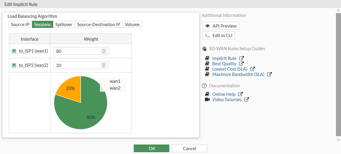

Sessions (weight-based)
The workload is distributing based on the number of sessions that are connected through the interface.
The weight that you assign to each interface is used to calculate the percentage of the total sessions that are allowed to connect through an interface, and the sessions are distributed to the interfaces accordingly.
Sessions with the same source and destination IP addresses (src-ip and dst-ip) are forwarded to the same path, but are still considered in later session ratio calculations.
An interface's weight value cannot be zero.

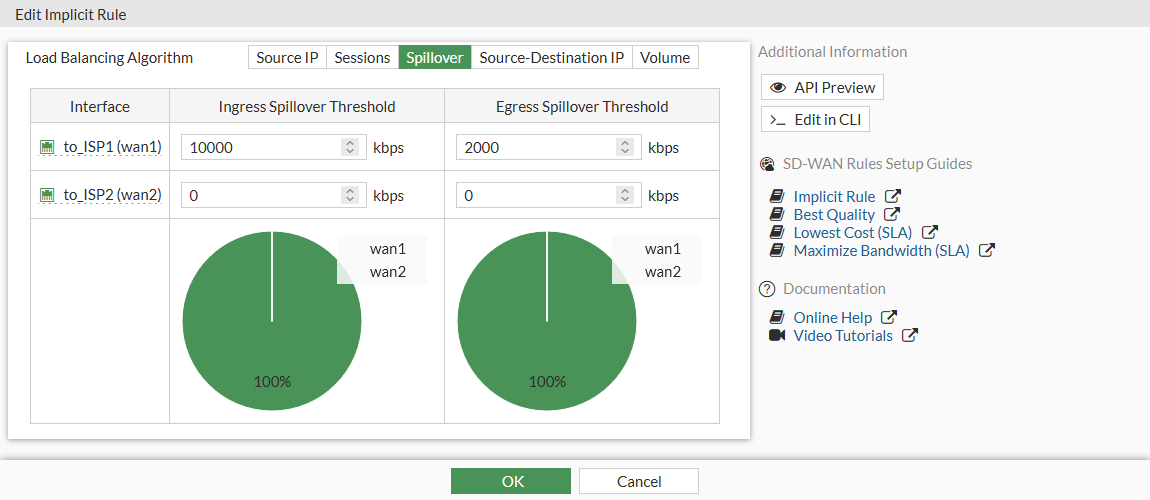

Spillover (usage-based)
The interface is used until the traffic bandwidth exceeds the ingress and egress thresholds that you set for that interface. Additional traffic is then sent through the next SD-WAN interface member.

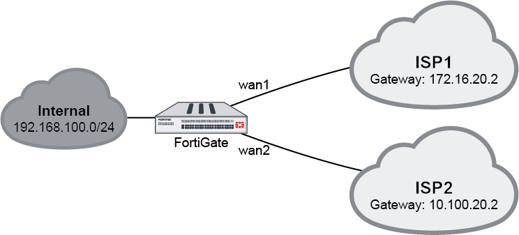

Example 1
Outgoing traffic is equally balanced between wan1 and wan2, using source-ip-based or source-dest-ip-based mode.

Example 2
Outgoing traffic is balanced between wan1 and wan2 with a customized ratio, using weight-based mode: wan1 runs 80% of the sessions, and wan2 runs 20% of the sessions.
Sessions with the same source and destination IP addresses (src-ip and dst-ip) will be forwarded to the same path, but will still be considered in later session ratio calculations.
Using the GUI:
  1. Go to Network > SD-WAN and select the SD-WAN Rules tab.
  2. Edit the sd-wan rule (the last default rule).
  3. For the Load Balancing Algorithm, select Sessions.
  4. Enter 80 in the wan1 field, and 20 in the wan2 field.
  5. Click OK.
Using the CLI:
config system sdwan
    set load-balance-mode weight-based
    config members
            set interface "wan1"
            set weight 80
            set interface "wan2"
            set weight 20

Example 4
Load balancing can be used to reduce costs when internet connections are charged at different rates. For example, if wan2 charges based on volume usage and wan1 charges a fixed monthly fee, we can use wan1 at its maximum bandwidth, and use wan2 for overflow.
In this example, wan1's bandwidth is 10Mbps down and 2Mbps up. Traffic will use wan1 until it reaches its spillover limit, then it will start to use wan2. Note that auto‑asic‑offload must be disabled in the firewall policy.
Using the GUI:
  1. On the FortiGate, enable SD-WAN and add wan1 and wan2 as SD-WAN members, then add a policy and static route. See SD-WAN quick start for details.
  2. Go to Network > SD-WAN and select the SD-WAN Rules tab.
  3. Edit the sd-wan rule (the last default rule).
  4. For the Load Balancing Algorithm, select Spillover.
  5. Enter 10000 in the wan1 Ingress Spillover Threshold field, and 2000 in the wan1 Egress Spillover Threshold field.
  6. Click OK.
Using the CLI:
config system sdwan
    set load-balance-mode usage-based
    config members
            set spillover-threshold 2000
            set ingress-spillover-threshold 10000
