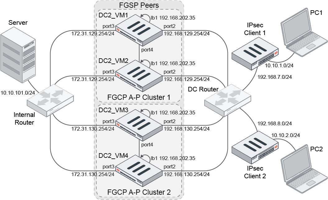

For additional redundancy, an FGCP cluster on one site may form FGSP peering with FGCP clusters on other sites. The FGCP over FGSP peers can still synchronize IPsec SAs and act as the primary gateway for individual tunnels for the same dialup servers. When failover happens within an FGCP cluster, tunnel traffic will failover to the other FGCP cluster member. When an FGCP cluster fails, tunnel traffic will failover to the other FGSP peer.
Example
In this example, each FGCP A-P cluster is connected on port4 as the heartbeat interface. The FGSP peers are connected on port5 over 172.31.2.1-2/24. Each FGSP peer and FGCP cluster has a loopback interface, lb1, with the same IP address. This loopback interface is used as the local gateway on each of the phase 1 connections to avoid each FGSP member having different IPs on port2. The DC Router uses ECMP to distribute traffic to each FGSP peer. It is assumed that the networking addresses are already configured properly.

There are two pairs of FGCP A-P HA clusters that form FGSP peering with each other. This is a typical FGCP over FGSP configuration used in large enterprises and service provider environments where high redundancy is needed. Each cluster uses the same loopback address for the local gateway. The DC Router uses ECMP to route traffic to the destination 192.168.202.31 through each of the participating FGSP peers.
In a larger scale there may be many more members in the FGCP clusters, more FGSP peers, and more IPsec dialup clients connecting. Each eligible FGSP peer will be the primary gateway for a set of dialup tunnels, and is in standby for the rest of the tunnels. When the FGCP cluster is configured in A-P mode, the tunnels will be established on the primary unit and synchronized to the standby unit.
The following configurations and example demonstrates PC1 initiating traffic to the Server. First, a dialup tunnel is formed between FortiGate IPsec Client 1 and DC2_VM1, which allows traffic to go through. IPsec SAs are synchronized to the FGCP standby unit, and to the FGSP peer. Upon failure of DC2_VM1, DC2_VM2 takes over as the primary of the HA cluster, and assumes the primary role for the failover tunnels.
If both DC2_VM1 and DC2_VM2 fail, the tunnels that were formed on this FGSP peer will now be re-routed to the other FGSP peer. The primary FGCP cluster member, DC2_VM3, will now pick up the tunnel traffic and assume the primary role for the failover tunnels.
