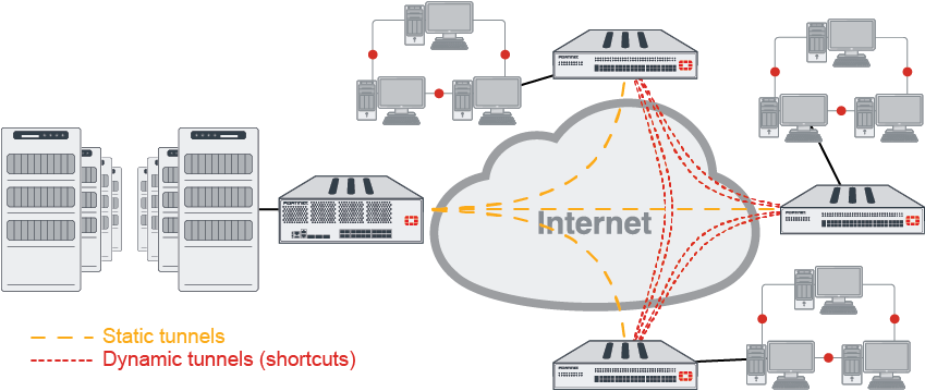

SD-WAN monitor on ADVPN shortcuts
SD-WAN monitors ADVPN shortcut link quality by dynamically creating link monitors for each ADVPN link. The dynamic link monitor on the spoke will use ICMP probes and the IP address of the gateway as the monitored server. These ICMP probes will not be counted as actual user traffic that keeps the spoke-to-spoke tunnel alive.
  • When no shortcut is established:
