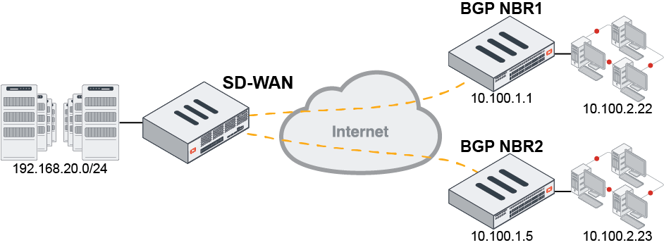

In this topology, a branch FortiGate has two SD-WAN gateways serving as the primary and secondary gateways. The gateways reside in different datacenters, but have a full mesh network between them.
This example shows how route-maps and service rules are selected based on performance SLAs and the member that is currently active. Traffic flows through the primary gateway unless the neighbor's health check is outside of its SLA. If that happens, traffic routes to the secondary gateway.
BGP NBR1 is the primary neighbor and BGP NBR2 is the secondary neighbor.
The branch FortiGate's wan1 and wan2 interfaces are members of the SD-WAN. When the SD-WAN neighbor status is primary, it will advertise community 20:1 to BGP NBR1 and 20:5 to BGP NBR2. When the SD-WAN neighbor status is secondary, it will advertise 20:5 to BGP NBR1 and 20:2 to BGP NBR2.
Only one of the primary or secondary neighbors can be active at one time. The SD-WAN neighbor status is used to decide which neighbor is selected:

Route map
SD-WAN is configured to let BGP advertise different communities when the SLA status changes. When the SLA is missed, it triggers BGP to advertise a different community to its BGP neighbor based on its route-map. The BGP neighbors can use the received community string to select the best path to reach the branch.
