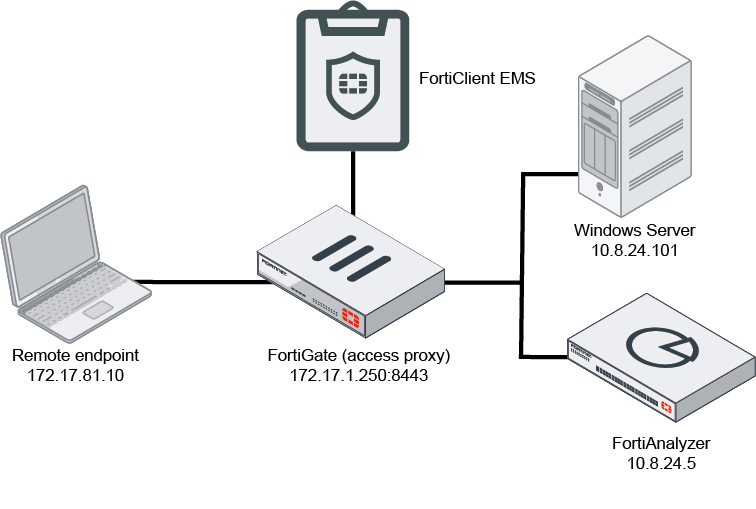

The following shows the topology for this example. This example uses two FQDNs, rdp.win.test and ssh.win.test, in place of the Windows server IP address, 10.8.24.100. This hides the internal IP address, 10.8.24.100, from end users.

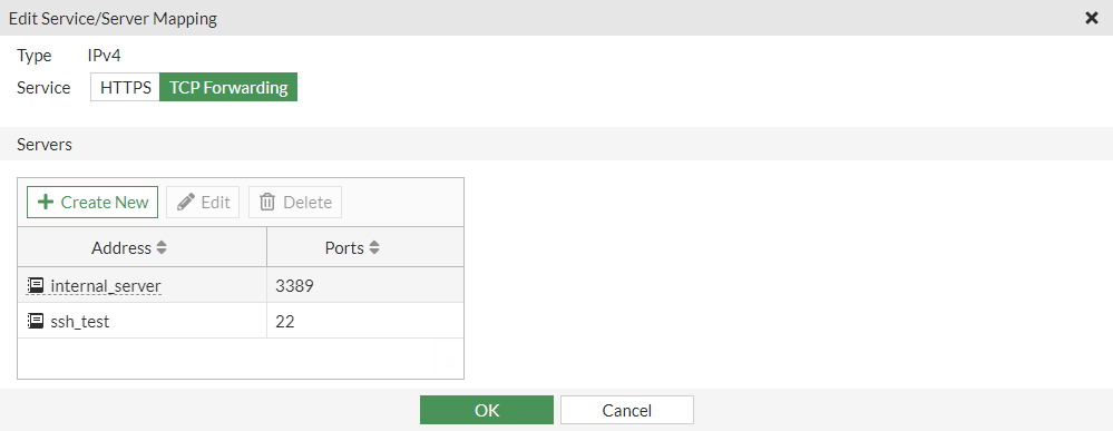

  1. In FortiOS, go to Policy & Objects > ZTNA > ZTNA Servers.
  2. Click Create New.
  3. For Type, select IPv4.
  4. For Service, select TCP Forwarding.
  5. Under Servers, configure RDP and SSH services.
  6. Click OK.
