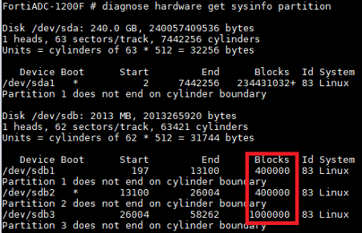

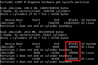

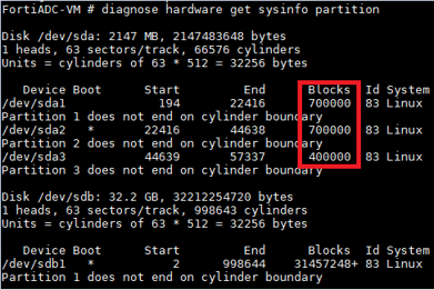

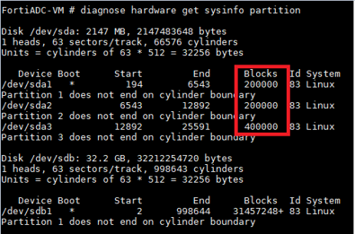

Verifying Successful Data Partition Expansion
After performing an upgrade to FortiADC version 7.6.2 or later, the data partition will be expanded to provide increased storage capacity. To verify that the expansion has been successfully applied, you can use the following CLI command:
diagnose hardware get sysinfo partition
This command returns detailed information on the system’s storage partitions, including the size of the data partition. By comparing the partition size values before and after the upgrade, you can confirm that the partition has been expanded as expected.
Example output comparison:
Platform
Before Upgrade to 7.6.2
After Upgrade to 7.6.2
Hardware (1200F)
Virtual Machine
