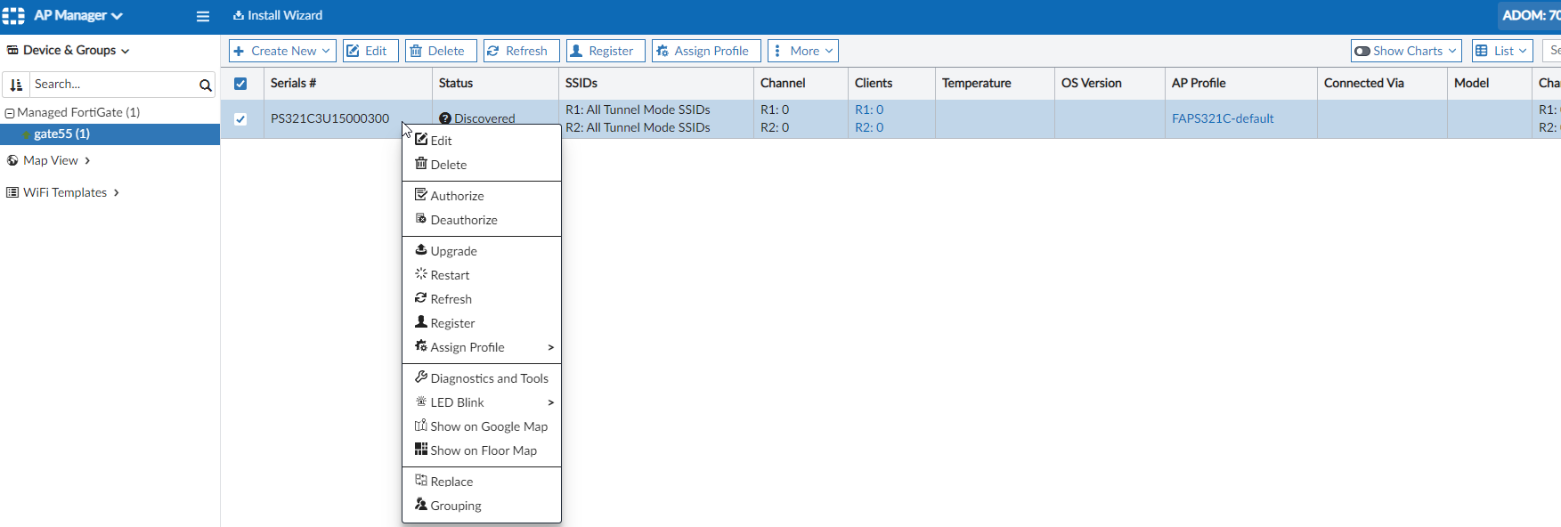

- Right-click on a FortiAP device in the table and click Deauthorize.

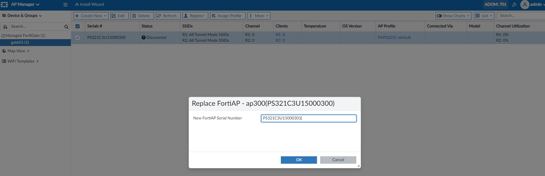

- When the device's status is Unauthorized, right-click on the same FortiAP device and click Replace.
- Enter the new FortiAP serial number, and click OK.

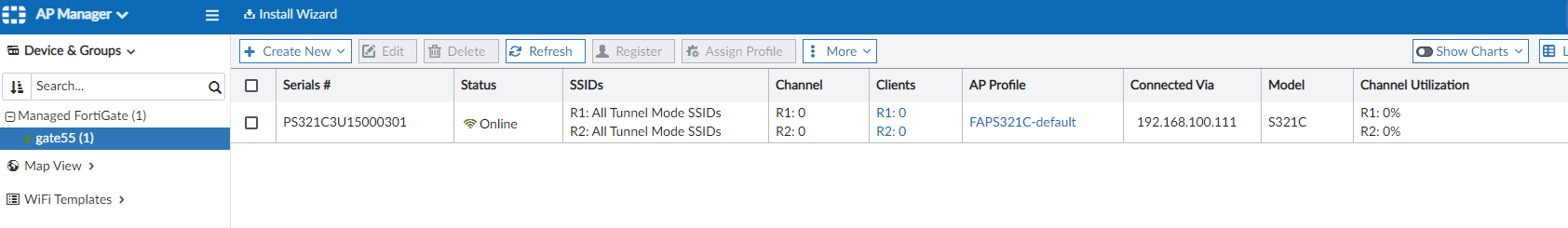

After the FortiAP has been replaced successfully, refresh the page and the new FortiAP is displayed. - Authorize the FortiAP device, then connect the FortiAP to the FortiGate.
- Power on the FortiAP device. After a few minutes, the FortiAP is displayed as Online.
You can view the replacement serial number in the Replacement Serial Number column in the Managed FortiSwitches table.
