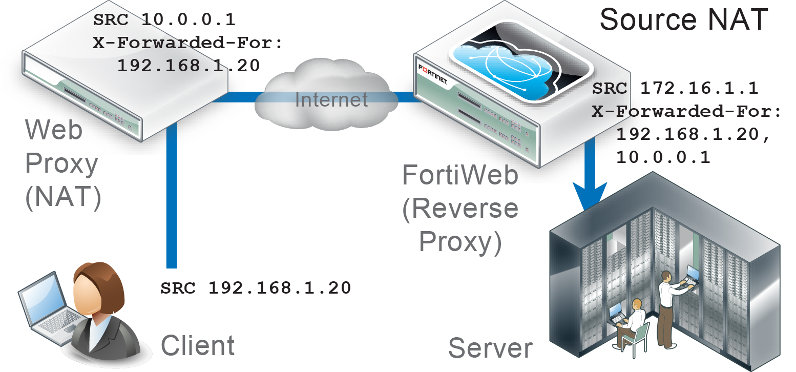

In some topologies, you must configure FortiWeb’s use of X-headers such as X-Forwarded-For:, X-Real-IP:, or True-Client-IP:, including when:
  • FortiWeb has been deployed behind a proxy/load balancer which applies NAT. Connection-wise, this causes all requests appear to come from the IP address of the proxy or load balancer, not the original client. FortiWeb requires the true client’s source IP so that when blocking attacks, it does not block the proxy/load balancer’s IP, affecting innocent requests. FortiWeb also requires some way to derive the original client’s IP so that attack logs and reports to show the IP of the actual attacker, rather than misleadingly blaming the load balancer.
  • The web server needs the client’s source IP address for purposes such as analytics, but FortiWeb is operating in Reverse Proxy mode, which applies NAT, and therefore all requests appear to come from FortiWeb’s IP address.
Due to source NAT (SNAT), a packet’s source address in its IP layer may have been changed, and therefore the original address of the client may not be directly visible to FortiWeb and/or its protected web servers. During a packet’s transit from the client to the web server, it could be changed several times: web proxies, load balancers, routers, and firewalls can all apply NAT.
Depending on whether the NAT devices are HTTP-aware, the NAT device can record the packet’s original source IP address in the HTTP headers. HTTP X-headers such as X-Real-IP: can be used by FortiWeb instead to trace the original source IP (and each source IP address along the path) in request packets. They may also be used by back-end web servers for client analysis.
Affects of source NAT at the IP and HTTP layers of request packets when in-between devices are HTTP-aware
Indicating the original client’s IP to back-end web servers

Blocking the attacker’s IP, not your load balancer
When you configure Use X-Header to Identify Original Client’s IP, FortiWeb compensates for NAT in your data center by using an HTTP header to derive the client’s IP address. In this way, even if the connection is not established directly between the web browser and FortiWeb, but instead is relayed, with the last segment established between your proxy/load balancer’s IP and FortiWeb, FortiWeb will still be able to report and block the actual attacker, rather than your own infrastructure.
Only public IPs will be used. If the original client’s IP is a private network IP (e.g. 192.168.*, 172.16.*, 10.*), FortiWeb will instead use the first public IP before or after the original client’s IP in the HTTP header line. Whether this is counted from the left or right end of the header line depends on IP Location in X-Header. In most cases, this public IP will be the client’s Internet gateway, and therefore blocking based on this IP may affect innocent clients that share the attacker’s Internet connection. For details, seeShared IP.
To limit the performance impact, FortiWeb will analyze the HTTP header for the client’s IP only for the first request in the TCP/IP connection. As a result, it is not suitable for use behind load balancers that multiplex—that is, attempt to reduce total simultaneous TCP/IP connections by sending multiple, unrelated HTTP requests from different clients within the same TCP/IP connection. Symptoms of this misconfiguration include FortiWeb mistakenly attributing subsequent requests within the same TCP/IP connection to the IP found in the first request’s HTTP header, even though the X-header indicates that the request originated from a different client.
After FortiWeb has traced the original source IP of the client, FortiWeb will use it in attack logs and reports so that they reflect the true origin of the attack, not your load balancer or proxy. FortiWeb will also use the original source IP as the basis for blocking when using some features that operate on the source IP:

Like addresses at the IP layer, attackers can spoof and alter addresses in the HTTP layer. Do not assume that they are 100% accurate, unless there are anti-spoofing measures in place such as defining trusted providers of X-headers.
For example, on FortiWeb, if you provide the IP address of the proxy or load balancer, when blocking requests and writing attack log messages or building reports, instead of using the SRC field in the IP layer of traffic as the client’s IP address (which would cause all attacks to appear to originate from the load balancer), FortiWeb can instead find the client’s real IP address in the X-Forwarded-For: HTTP header. FortiWeb could also add its own IP address to the chain in X-Forwarded-For:, helping back-end web servers that require the original client’s source IP for purposes such as server-side analytics—providing news in the client’s first language or ads relevant to their city, for example.
Like IP-layer NAT, some networks also translate addresses at the HTTP layer. In those cases, enabling Use X-Header to Identify Original Client’s IP may have no effect. To determine the name of your network’s X-headers, if any, and to see whether or not they are translated, use diagnose network sniffer in the CLI or external packet capture software such as Wireshark.
To configure FortiWeb to obtain the packet’s original source IP address from an HTTP header

    If FortiWeb is deployed behind a device that applies NAT, enable this option to derive the original client’s source IP address from an HTTP X-header, instead of the SRC field in the IP layer. Then type the key such as X-Forwarded-For or X-Real-IP, without the colon ( : ), of the X-header that contains the original source IP address of the client.
    This HTTP header is often X-Forwarded-For: when traveling through a web proxy, but can vary. For example, the Akamai service uses True-Client-IP:.
    For deployment guidelines and mechanism details, see Blocking the attacker’s IP, not your load balancer.
    Caution: To combat forgery, configure the IP addresses of load balancers and proxies that are trusted providers of this header. Also configure those proxies/load balancers to reject fraudulent headers, rather than passing them to FortiWeb.
