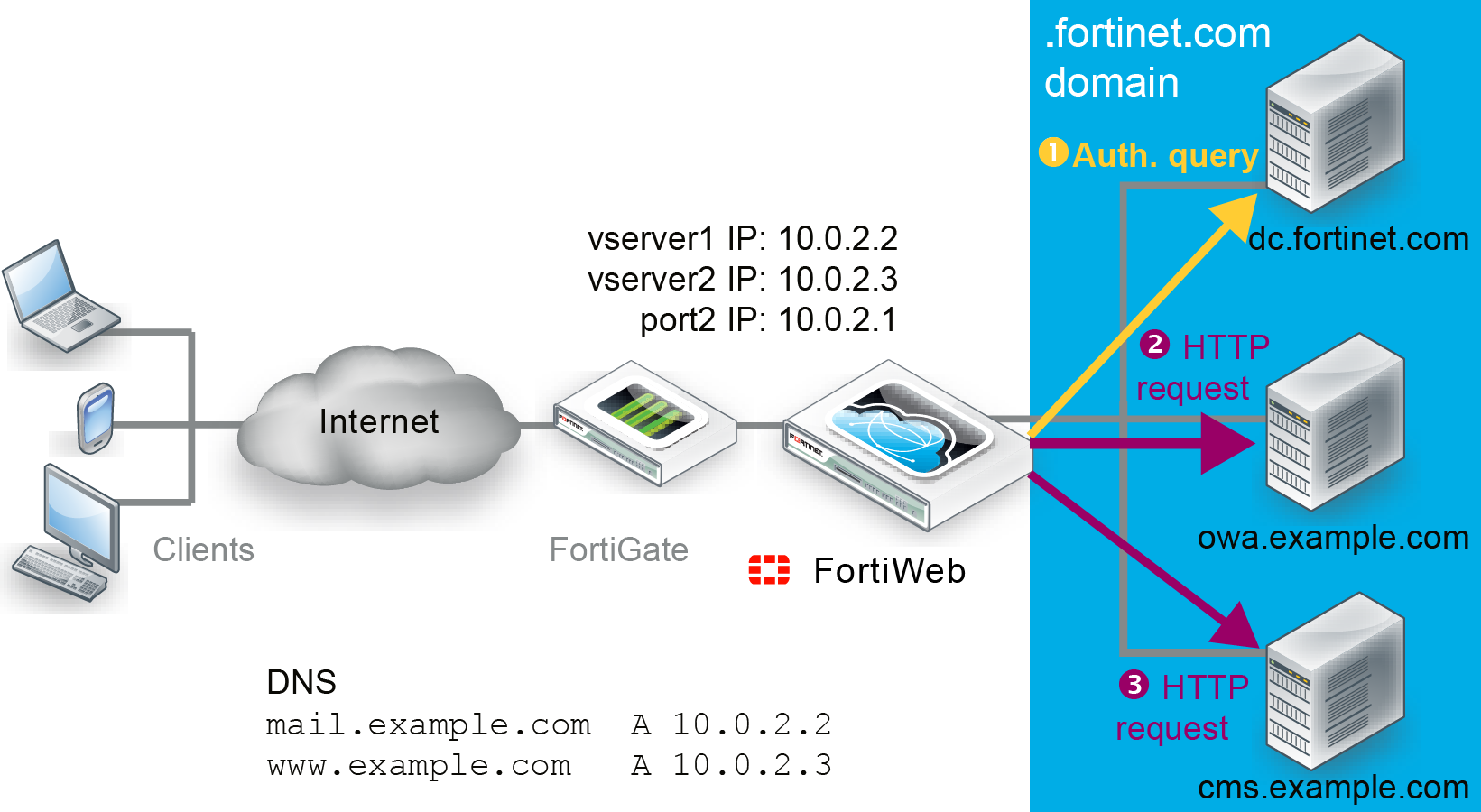

For example, if you configure HTML form authentication, when FortiWeb receives the first request, it returns an HTML authentication form.
FortiWeb’s HTTP authentication form
FortiWeb forwards the client’s credentials in a query to the authentication server. Once the client is successfully authenticated, if you have configured FortiWeb to delegate, FortiWeb forwards the credentials to the web application. The server’s response is returned to the client. Until the session expires, subsequent requests from the client to the same or other web applications in the same domain do not require the client to authenticate again.
