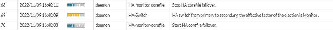

As above, the Corefile and Available ports share the same factor “Monitor” in selection, just the corefile has higher weight. So if a proxyd coredump is detected on the primary device, the weight of corefile-ha-failover will be reduced thus the total weight of Monitor will become lower than that of other secondary devices, then HA failover will take place.
In event logs, HA failover triggered by corefile-ha-failover will be also recorded like as “HA switch from primary to secondary, the effective factor of the election is Monitor”:

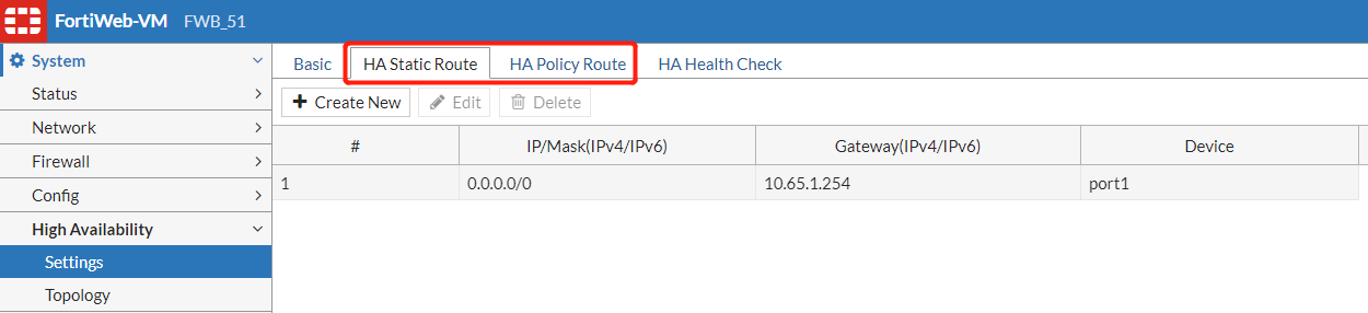

How to manage HA nodes, especially the secondary nodes via SSH or GUI?
If HA is deployed in active-passive or standard active-active modes, it’s necessary to add a reserved management interface (or interfaces) and HA static/policy route to manage HA nodes, especially the secondary nodes.
This option is not a MUST for HA setup but is necessary for active-passive and standard active-active modes, because in these two modes, the IP address and other settings on all interfaces will be synchronized to other HA members unless a port is set as “Reserved Management Interface”.
If the reserved network interfaces are not in the same subnet with the management computer, you need to configure the next-hop gateways in HA Static Route or HA Policy route
CLI:
config system ha-mgmt-router-static
config system ha-mgmt-router-policy
GUI:
