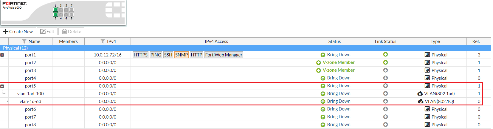

Adding VLAN subinterfaces
You can add a virtual local area network (VLAN) subinterface to a network interface or bridge on the FortiWeb appliance, up to a maximum of 512 VLAN in total.
Similar to a local area network (LAN), use a IEEE 802.1q (http://www.ieee802.org/1/pages/802.1Q.html) VLAN to reduce the size of a broadcast domain and thereby reduce the amount of broadcast traffic received by network hosts, improving network performance.
In True Transparent Proxy mode, to expand the VLAN space, Q-in-Q is introduced for FortiWeb to stack 802.1Q and 802.1ad (http://www.ieee802.org/1/pages/802.1Q.html) headers in the Ethernet frame, so that multiple VLANs are reused in a core VLAN. The 802.1Q VLAN (Ethernet Type = 0x8100) can be packed into the 802.1ad VLAN (Ethernet Type = 0x88A8). If you create a 802.1ad VLAN per a physical interface, then you can create a 802.1Q VLAN per 802.1ad VLAN. Packets will be tagged by two VLANs.
VLANs are not designed to be a security measure, and should not be used where untrusted devices and/or individuals outside of your organization have access to the equipment. VLAN tags are not authenticated, and can be ignored or modified by attackers. VLAN tags rely on the voluntary compliance of the receiving host or switch. |
Unlike physical LANs, VLANs do not require you to install separate hardware switches and routers to achieve this effect. Instead, VLAN-compliant switches, such as FortiWeb appliances, restrict broadcast traffic based upon whether its VLAN ID matches that of the destination network. As such, VLAN trunks can be used to join physically distant broadcast domains as if they were close.
The VLAN ID is part of the tag that is inserted into each Ethernet frame in order to identify traffic for a specific VLAN. VLAN header addition is handled automatically by FortiWeb appliances, and does not require that you adjust the maximum transmission unit (MTU). Depending on whether the device receiving a packet operates at Layer 2 or Layer 3 of the network, this tag may be added, removed, or rewritten before forwarding to other nodes on the network.
Cisco Discovery Protocol (CDP) is supported for VLANs, including when FortiWeb is operating in either of the transparent modes.
If your FortiWeb model uses Data Plane Development Kit (DPDK) for packet processing (for example, models 3000E, 3010E and 4000E), you cannot use VLAN subinterfaces as a data capture port for Offline Protection mode. For these models, remove any VLAN configuration on an interface before you use it for data capture. These models fully support the capture and transmission of VLAN traffic.
To configure a VLAN subinterface
- Go to System > Network > Interface.
To access this part of the web UI, your administrator's account access profile must have Read and Write permission to items in the Network Configuration category. For details, see Permissions. - Click Create New.
- Configure these settings:
- If one physical network port (that is, a VLAN trunk) will handle multiple VLANs, create multiple VLAN subinterfaces on that port, one for each VLAN ID that will be received.
- If multiple different physical network ports will handle the same VLANs, on each of the ports, create VLAN subinterfaces that have the same VLAN IDs.
- ICMP type 8 (
ECHO_REQUEST) - UDP ports 33434 to 33534
- Click OK.
| Name | Type the name (for example, vlan100) of this VLAN subinterface that can be referenced by other parts of the configuration. The maximum length is 15 characters.Tip: The name cannot be changed once you save the entry. For a workaround, see Renaming entries. |
| Type | Select VLAN. | |
| Interface | Select the name of the physical network port with which the VLAN subinterface will be associated. | |
| VLAN ID |
Type the VLAN ID , such as The valid range is between 1 and 4094 and must match the VLAN ID added by the IEEE 802.1q-compliant router or switch connected to the VLAN subinterface. For the maximum number of interfaces for your FortiWeb model, including VLAN subinterfaces, see Appendix B: Maximum configuration values. |
| VLAN Protocol | Select a VLAN type 802.1Q or 802.1ad. | |
| Addressing Mode | Specify whether FortiWeb acquires an IPv4/IPv6 address for this VLAN using DHCP. |
| IP/Netmask | Type the IP address/subnet mask associated with the VLAN, if any. The IP address must be on the same subnet as the network to which the interface connects. Two network interfaces cannot have IP addresses on the same subnet. | |
| Administrative Access | Enable the types of administrative access that you want to permit to this interface. These options do not disable outgoing administrative connections, such as update polling connections to the FDN or outgoing ICMP resulting from a CLI command such as execute ping. Neither do they govern traffic destined for a web server or virtual server, which are governed by policies. These options only govern incoming connections destined for the appliance itself.Caution: Enable only on network interfaces connected to trusted private networks (defined in Trusted Host, Administrators, Administrators) or directly to your management computer. If possible, enable only secure administrative access protocols such as HTTPS or SSH. Failure to restrict administrative access could compromise the security of your FortiWeb appliance. |
| HTTPS | Enable to allow secure HTTPS connections to the web UI through this network interface. To configure the listening port number, see Global web UI & CLI settings. | |
| PING |
Enable to allow:
for Note: Disabling PING only prevents FortiWeb from receiving ICMP type 8 ( It does not disable FortiWeb CLI commands such as |
| HTTP |
Enable to allow HTTP connections to the web UI through this network interface. To configure the listening port number, see Global web UI & CLI settings. The HTTP access to FortiWeb's GUI will be automatically redirected to HTTPS, so you can't enable HTTP alone, it should be enabled along with HTTPS. |
| SSH | Enable to allow SSH connections to the CLI through this network interface. | |
| SNMP | Enable to allow SNMP queries to this network interface, if queries have been configured and the sender is a configured SNMP manager. To configure the listening port number and configure queries and traps, see SNMP traps & queries. | |
| FortiWeb Manager | Enable to allow FortiWeb Manager to connect to this appliance using this network interface. | |
| WCCP Protocol | Select if the interface is used to communicate with a FortiGate unit configured as a WCCP server. Available only when the operation mode is WCCP. For details, see Setting the operation mode and Configuring FortiWeb to receive traffic via WCCP. |
Your new VLAN is initially hidden in the list of network interfaces.
To expand the network interface listing in order to view all of a port’s associated VLANs, click the + (plus sign) beside the name of the port.

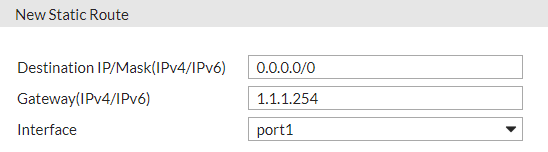

You must configure FortiWeb with at least one static route that points to a router, often a router that is the gateway to the Internet. You may need to configure multiple static routes if you have multiple gateway routers (e.g. each of which should receive packets destined for a different subset of IP addresses), redundant routers (e.g. redundant Internet/ISP links), or other special routing cases.
However, often you will only need to configure one route: a default route.
For example, if a web server is directly attached to one physical port on the FortiWeb, but all other destinations, such as connecting clients, are located on distant networks, such as the Internet, you might need to add only one route: a default route that indicates the gateway router through which FortiWeb sends traffic towards the Internet.
If your management computer is not directly attached to one of the physical ports of the FortiWeb appliance, you may also require a static route so that your management computer is able to connect with the web UI and CLI. |

To add a static route via the web UI
- Go to System > Network > Route and select the Static Route tab.
To access this part of the web UI, your administrator account’s access profile must have Read and Write permission to items in the Router Configuration category. For details, see Permissions. - Click Create New.
- Click OK.
- To verify connectivity, from a host on the route’s destination network, attempt to connect to the FortiWeb appliance’s web UI via HTTP and/or HTTPS. (At this point in the installation, you have not yet configured a policy, and therefore, if in Reverse Proxy mode, cannot test connectivity through the FortiWeb.)
| Destination IP/Mask | Type the destination IP address and network mask of packets that will be subject to this static route, separated by a slash ( / ). The value 0.0.0.0/0.0.0.0 or ::/0 results in a default route, which matches the DST field in the IP header of all packets. |
| Gateway | Type the IP address of the next-hop router where the FortiWeb forwards packets subject to this static route. This router must know how to route packets to the destination IP addresses that you have specified in Destination IP/Mask, or forward packets to another router with this information. For a direct Internet connection, this is the router that forwards traffic towards the Internet, and could belong to your ISP. Caution: The gateway IP address must be in the same subnet as the interface’s IP address. Failure to do so will cause FortiWeb to delete all static routes, including the default gateway. |
| Interface | Select the name of the network interface through which the packets subject to the static route will egress towards the next-hop router. |
Making a default route for your FortiWeb is a typical best practice: if there is no other, more specific static route defined for a packet’s destination IP address, a default route will match the packet, and pass it to a gateway router so that any packet can reach its destination. If you do not define a default route, and if there is a gap in your routes where no route matches a packet’s destination IP address, packets passing through the FortiWeb towards those IP addresses will, in effect, be null routed. While this can help to ensure that unintentional traffic cannot leave your FortiWeb and therefore can be a type of security measure, the result is that you must modify your routes every time that a new valid destination is added to your network. Otherwise, it will be unreachable. A default route ensures that this kind of locally-caused “destination unreachable” problem does not occur. |
The FortiWeb appliance should now be reachable to connections with networks indicated by the mask.

To add a default route via the CLI
- Enter the following commands:
config router static
edit <route_index>
set gateway <gateway_ipv4>
set device <interface_name>
where:
<route_index>is the index number of the route in the list of static routes<gateway_ipv4>is the IP address of the gateway router<interface_name>is the name of the network interface through which packets will egress, such asport1

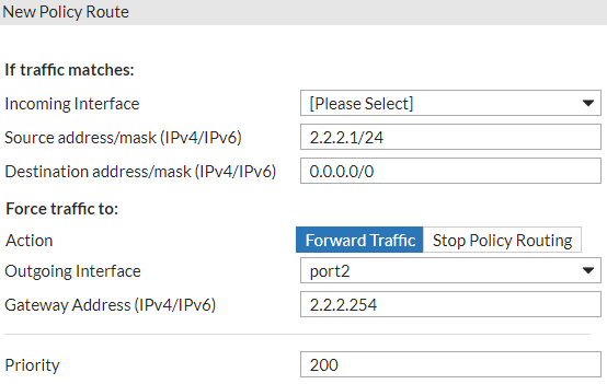

Using policy route to divert traffic based on source IPs
We will use the following network topology as an example to illutrate how to use policy routes to divert traffic based on the source IP in the response package.
To direct FortiWeb's outgoing traffic to the default gateway (1.1.1.254) and gateway2 (2.2.2.254):
- Configure the following policy route so that the package with source IP 2.2.2.1/24 will exit FortiWeb through port2 to the next-hop gateway whose IP address is 2.2.2.254.
Make sure not to select the incoming interface, because in Reverse Proxy mode FortiWeb does not carry the incoming interface information in the outgoing package.
- Configure the following static route so that all the other traffic which doesn't match the conditions specified in the policy route will be forwarded to the default gateway whose IP address is 1.1.1.254.
Policy route has higher priority than the static route. In this example, the package exiting FortiWeb with source IP 2.2.2.1 matches both the static route and policy route, but the system only applies policy route to the package because policy route has higher priority.
In this case, the source IPs in the outgoing package are either 2.2.2.1 or 1.1.1.1, so, instead of configuring a static route, you can alternatively configure another policy route specifying the Source address as 1.1.1.1/24, the Outgoing Interface as port1, and Gateway Address as 1.1.1.254. |

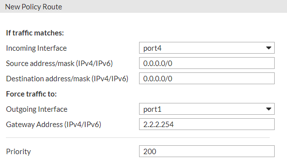

Using policy route and the ip-forward command to configure FortiWeb as a router
In Reverse Proxy mode, policy route can also be used together with the ip-forward command to configure FortiWeb as a router to forward the non-HTTP/HTTPS traffic to back-end servers. The non-HTTP/HTTPS traffic is handled in the following ways:
- Any non-HTTP/HTTPS traffic destined for a virtual server on the appliance is dropped.
- For any non-HTTP/HTTPS traffic destined for another destination (for example, a back-end server), FortiWeb acts as a router and forwards it to its destination address. The incoming and outgoing interfaces configured in the policy routes are used to forward the non-HTTP/HTTPS traffic.
For example, you can create a policy route with the following settings so that all the traffic from the incoming interface port4 will exit FortiWeb through the outgoing interface port1.
Then, connect to FortiWeb's CLI and run the following command to enable ip-forward:

To create a policy route
- Go to System > Network > Route and select Policy Route tab.
- Complete the following settings:
- Click OK.
If traffic matches: |
| Incoming Interface | Select the interface on which FortiWeb receives packets it applies this routing policy to. |
| Source address/mask (IPv4/IPv6) | Enter the source IP address and network mask to match. When a packet matches the specified address, FortiWeb routes it according to this policy. |
| Destination address/mask (IPv4/IPv6) | Enter the destination IP address and network mask to match. When a packet matches the specified address, FortiWeb routes it according to this policy. |
Fwmark |
Enter the Fwmark value specified in Firewall Fwmark Policy. If you don't need to match traffic against the Fwmark value, enter value 0. The valid range is 0-255. |
Force traffic to: |
Action |
Forward Traffic: FortiWeb filters traffic against the specified conditions and forwards the traffic to this policy route. Stop Policy Routing: FortiWeb filters traffic against the specified conditions and forwards the traffic according to the matched static route. |
| Outgoing Interface | Select the interface through which FortiWeb routes packets that match the specified IP address information. |
| Gateway Address (IPv4/IPv6) | Enter the IP address of the next-hop router where FortiWeb forwards packets that match the specified IP address information. Ensure this router knows how to route packets to the destination IP address or forwards packets to another router with this information. A gateway address is not required for the particular routing policies used as static routes in an one-arm topology. Please leave this blank for one-arm topology. |
| Priority | Enter a value between 1 and 200 that specifies the priority of the route. When packets match more than one policy route, FortiWeb directs traffic to the route with the lowest value. |
Notice for using policy route in an one-arm topology
Since FortiWeb's policy route has higher priority than static route (any packet will be evaluated against policy routes first, then static routes), when a FortiWeb is deployed in a one-arm topology (see Planning the network topology) and any policy route is configured for the FortiWeb to access to other networks, you are strongly recommended to add particular policy routes with higher priority for the static routing within the connected network subnets.
A policy route might be set for updating the signature and virus databases through the Internet. In this example, packets that FortiWeb forwards for Reverse Proxy mode within subnet 192.0.2.0/24 might match the policy route first rather than the static route, and so that the packets might be directed to incorrect path (which result in a failed Reverse Proxy). Therefore, no matter what the configurations you have for the policy routes, we strongly suggest an extra policy route being set (for this example) like
Destination address/mask = 192.0.2.0/24
Outgoing Interface = port3
Priority = 10
Configuration of the particular policy route is a static route for choosing port 3 as the path to forward packets destined to subnet 192.0.2.0/24. To make sure all the packets are evaluated against the particular policy routes before other normal policy routes, those particular policy routes must be assigned a higher (or the highest) priority than other policy routes'. This particular policy route, with a higher (or the highest) priority and no gateway being specified, essentially reverses the fact that policy routes have higher priority than static routes.
