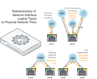

To connect to the CLI and web UI, you must assign at least one FortiWeb network interface (usually port1) with an IP address and netmask so that it can receive your connections. Depending on your network, you usually must configure others so that FortiWeb can connect to the Internet and to the web servers it protects.
How should you configure the other network interfaces? Should you add more? Should each have an IP address? That varies. In some cases, you may not want to assign IP addresses to the other network interfaces.
Initially, each physical network port (or, on FortiWeb-VM, a vNIC) has only one network interface that directly corresponds to it — that is, a “physical network interface.” Multiple network interfaces (“subinterfaces” or “virtual interfaces”) can be associated with a single physical port, and vice versa (“redundant interfaces”/”NIC teaming”/”NIC bonding” or “aggregated links”). These can provide features such as link failure resilience or multi-network links.
FortiWeb does not currently support IPSec VPN, so the virtual interfaces for IPSec VPN are not supported. If you require these features, implement them separately on your FortiGate, VPN appliance, or firewall. |
Usually, each network interface has at least one IP address and netmask. However, this is not true for bridges.
Bridges (V-zones) allow packets to travel between the FortiWeb appliance’s physical network ports over a physical layer link, without an IP layer connection with those ports.

Link aggregation
You can configure a network interface that is the bundle of several physical links via either the web UI or the CLI.
The Link Aggregation Control Protocol (LACP) is currently supported only when FortiWeb is deployed in Reverse Proxy or True Transparent Proxy mode. It can be applied to VLAN subinterfaces. It cannot be applied to ports that are used for the HA heartbeat, but it can be applied to monitor ports in an HA cluster. It is not supported in FortiWeb-VM. |
Link aggregation (also called NIC teaming/bonding or link bundling) forms a network interface that queues and transmits over multiple wires (also called a port channel), instead of only a single wire (as FortiWeb would normally do with a single network interface for each physical port). This multiplies the bandwidth that is available to the network interface, and therefore is useful if FortiWeb will be inline with your network backbone.
Link aggregation on FortiWeb complies with IEEE 802.3ad (http://grouper.ieee.org/groups/802/3/ad/index.html) and distributes Ethernet frames using a modified round-robin behavior. If a port in the aggregate fails, traffic is redistributed automatically to the remaining ports with the only noticeable effect being a reduced bandwidth. When broadcast or multicast traffic is received on a port in the aggregate interface, reverse traffic will return on the same port.
When link aggregation uses a round-robin that considers only Layer 2, Ethernet frames that comprise an HTTP request can sometimes arrive out of order. Because network protocols at higher layers often do not gracefully handle this (especially TCP, which may decrease network performance by requesting retransmission when the expected segment does not arrive), FortiWeb’s frame distribution algorithm is configurable.
For example, if you notice that performance with link aggregation is not as high as you expect, you could try configuring FortiWeb to queue related frames consistently to the same port by considering the IP session (Layer 3) and TCP connection (Layer 4), not simply the MAC address (Layer 2).
You must also configure the router, switch, or other link aggregation control protocol (LACP)-compatible device at the other end of FortiWeb’s network cables to match, with identical:

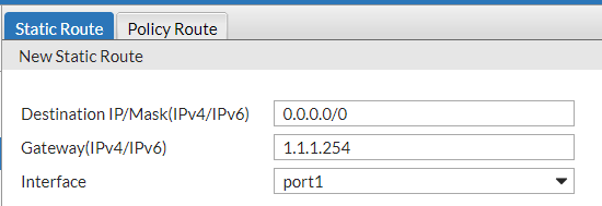

- Configure the following static route so that all the other traffic which doesn't match the conditions specified in the policy route will be forwarded to the default gateway whose IP address is 1.1.1.254.
Policy route has higher priority than the static route. In this example, the package exiting FortiWeb with source IP 2.2.2.1 matches both the static route and policy route, but the system only applies policy route to the package because policy route has higher priority.
