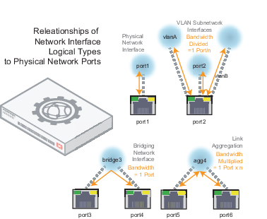

Initially, each physical network port (or, on FortiWeb-VM, a vNIC) has only one network interface that directly corresponds to it — that is, a “physical network interface.” Multiple network interfaces (“subinterfaces” or “virtual interfaces”) can be associated with a single physical port, and vice versa (“redundant interfaces”/”NIC teaming”/”NIC bonding” or “aggregated links”). These can provide features such as link failure resilience or multi-network links.
FortiWeb does not currently support IPSec VPN, so the virtual interfaces for IPSec VPN are not supported. If you require these features, implement them separately on your FortiGate, VPN appliance, or firewall.
Usually, each network interface has at least one IP address and netmask. However, this is not true for bridges.
Bridges (V-zones) allow packets to travel between the FortiWeb appliance’s physical network ports over a physical layer link, without an IP layer connection with those ports.

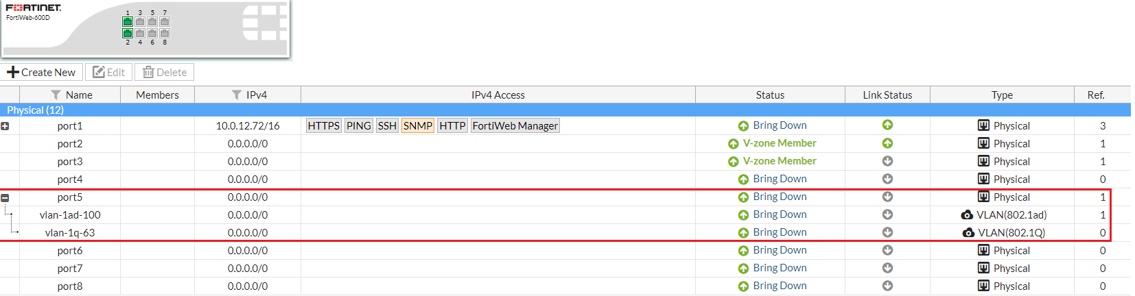

  6. Your new VLAN is initially hidden in the list of network interfaces.
    To expand the network interface listing in order to view all of a port’s associated VLANs, click the + (plus sign) beside the name of the port.

    Since FortiWeb 6.1 release, vlan subinterfaces including 802.1Q, 802.1ad and physical interfaces can be configured in one V-zone.
    Note: Only network interfaces with no IP address can belong to a bridge. port1 is reserved for your management computer, and cannot be bridged. To remove any other network interface’s IP address so that it can be included in the bridge, set its IP/Netmask to 0.0.0.0/0.0.0.0.

    You can configure a network interface that is the bundle of several physical links via either the web UI or the CLI.
    The Link Aggregation Control Protocol (LACP) is currently supported only when FortiWeb is deployed in Reverse Proxy or True Transparent Proxy mode. It can be applied to VLAN subinterfaces. It cannot be applied to ports that are used for the HA heartbeat, but it can be applied to monitor ports in an HA cluster. It is not supported in FortiWeb-VM.
    Link aggregation (also called NIC teaming/bonding or link bundling) forms a network interface that queues and transmits over multiple wires (also called a port channel), instead of only a single wire (as FortiWeb would normally do with a single network interface for each physical port). This multiplies the bandwidth that is available to the network interface, and therefore is useful if FortiWeb will be inline with your network backbone.
    Link aggregation on FortiWeb complies with IEEE 802.3ad (http://grouper.ieee.org/groups/802/3/ad/index.html) and distributes Ethernet frames using a modified round-robin behavior. If a port in the aggregate fails, traffic is redistributed automatically to the remaining ports with the only noticeable effect being a reduced bandwidth. When broadcast or multicast traffic is received on a port in the aggregate interface, reverse traffic will return on the same port.
    When link aggregation uses a round-robin that considers only Layer 2, Ethernet frames that comprise an HTTP request can sometimes arrive out of order. Because network protocols at higher layers often do not gracefully handle this (especially TCP, which may decrease network performance by requesting retransmission when the expected segment does not arrive), FortiWeb’s frame distribution algorithm is configurable.
    For example, if you notice that performance with link aggregation is not as high as you expect, you could try configuring FortiWeb to queue related frames consistently to the same port by considering the IP session (Layer 3) and TCP connection (Layer 4), not simply the MAC address (Layer 2).
    You must also configure the router, switch, or other link aggregation control protocol (LACP)-compatible device at the other end of FortiWeb’s network cables to match, with identical:
    • Link speed
    • duplex/simplex setting
    • ports that can be aggregated
    This will allow the two devices to use the cables between those ports to form a trunk, not an accidental Layer 2 (link) network loop. FortiWeb will use LACP to:
    • detect suitable links between itself and the other device, and form a single logical link
    • detect individual port failure so that the aggregate can redistribute queuing to avoid a failed port

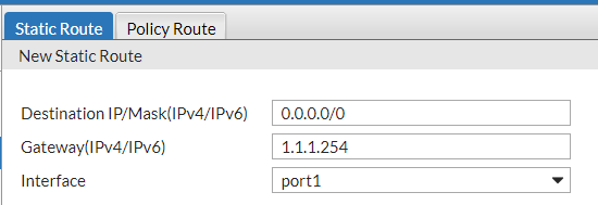

    Adding a gateway
    Static routes direct traffic exiting the FortiWeb appliance based upon the packet’s destination—you can specify through which network interface a packet leaves and the IP address of a next-hop router that is reachable from that network interface. Routers are aware of which IP addresses are reachable through various network pathways and can forward those packets along pathways capable of reaching the packets’ ultimate destinations. Your FortiWeb itself does not need to know the full route, as long as the routers can pass along the packet.
    True transparent and Transparent Inspection operation modes require that you specify the gateway when configuring the operation mode. In that case, you have already configured a static route. You do not need to repeat this step.
    You must configure FortiWeb with at least one static route that points to a router, often a router that is the gateway to the Internet. You may need to configure multiple static routes if you have multiple gateway routers (e.g. each of which should receive packets destined for a different subset of IP addresses), redundant routers (e.g. redundant Internet/ISP links), or other special routing cases.
    However, often you will only need to configure one route: a default route.
    For example, if a web server is directly attached to one physical port on the FortiWeb, but all other destinations, such as connecting clients, are located on distant networks, such as the Internet, you might need to add only one route: a default route that indicates the gateway router through which FortiWeb sends traffic towards the Internet.
    If your management computer is not directly attached to one of the physical ports of the FortiWeb appliance, you may also require a static route so that your management computer is able to connect with the web UI and CLI.
    When you add a static route through the web UI, the FortiWeb appliance evaluates the route to determine if it represents a different route compared to any other route already present in the list of static routes. If no route having the same destination exists in the list of static routes, the FortiWeb appliance adds the static route, using the next unassigned route index number. The index number of the route in the list of static routes is not necessarily the same as its position in the routing table (diagnose network route list).
    You can also configure FortiWeb to route traffic to a specific network interface/gateway combination based on a packet’s source and destination IP address, instead of the static route configuration. For details, see Creating a policy route.
    To add a static route via the web UI
    1. Go to System > Network > Route and select the Static Route tab.
      To access this part of the web UI, your administrator account’s access profile must have Read and Write permission to items in the Router Configuration category. For details, see Permissions.
    2. Click Create New.
    3. Configure these settings:
    4. Destination IP/Mask Type the destination IP address and network mask of packets that will be subject to this static route, separated by a slash ( / ).
      The value 0.0.0.0/0.0.0.0 or ::/0 results in a default route, which matches the DST field in the IP header of all packets.
      Gateway Type the IP address of the next-hop router where the FortiWeb forwards packets subject to this static route. This router must know how to route packets to the destination IP addresses that you have specified in Destination IP/Mask, or forward packets to another router with this information.
      For a direct Internet connection, this is the router that forwards traffic towards the Internet, and could belong to your ISP.
      Caution: The gateway IP address must be in the same subnet as the interface’s IP address. Failure to do so will cause FortiWeb to delete all static routes, including the default gateway.
      Interface Select the name of the network interface through which the packets subject to the static route will egress towards the next-hop router.
      Making a default route for your FortiWeb is a typical best practice: if there is no other, more specific static route defined for a packet’s destination IP address, a default route will match the packet, and pass it to a gateway router so that any packet can reach its destination.
      If you do not define a default route, and if there is a gap in your routes where no route matches a packet’s destination IP address, packets passing through the FortiWeb towards those IP addresses will, in effect, be null routed. While this can help to ensure that unintentional traffic cannot leave your FortiWeb and therefore can be a type of security measure, the result is that you must modify your routes every time that a new valid destination is added to your network. Otherwise, it will be unreachable. A default route ensures that this kind of locally-caused “destination unreachable” problem does not occur.
    5. Click OK.
    6. The FortiWeb appliance should now be reachable to connections with networks indicated by the mask.

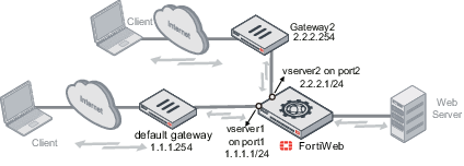

    We will use the following network topology as an example to illutrate how to use policy routes to divert traffic based on the source IP in the response package.

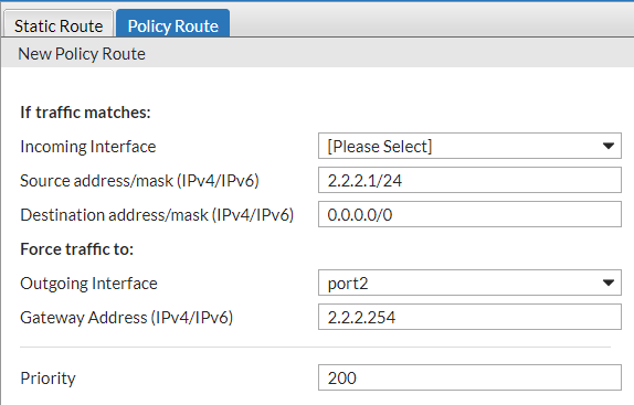

    To direct FortiWeb's outgoing traffic to the default gateway (1.1.1.254) and gateway2 (2.2.2.254):
    • Configure the following policy route so that the package with source IP 2.2.2.1/24 will exit FortiWeb through port2 to the next-hop gateway whose IP address is 2.2.2.254.
      Make sure not to select the incoming interface, because in Reverse Proxy mode FortiWeb does not carry the incoming interface information in the outgoing package.
    • Configure the following static route so that all the other traffic which doesn't match the conditions specified in the policy route will be forwarded to the default gateway whose IP address is 1.1.1.254.
    Policy route has higher priority than the static route. In this example, the package exiting FortiWeb with source IP 2.2.2.1 matches both the static route and policy route, but the system only applies policy route to the package because policy route has higher priority.
    tooltip icon In this case, the source IPs in the outgoing package are either 2.2.2.1 or 1.1.1.1, so, instead of configuring a static route, you can alternatively configure another policy route specifying the Source address as 1.1.1.1/24, the Outgoing Interface as port1, and Gateway Address as 1.1.1.254.

    1. Go to System > Network > Interface.
    2. To access this part of the web UI, your administrator's account access profile must have Read and Write permission to items in the Network Configuration category. For details, see Permissions.
      If the network interface’s Status column is Bring Up, its administrative status is currently “down” and it will not receive or emit packets, even if you otherwise configure it. To bring up the network interface, click the Bring Up link.
      This Status column is not the detected physical link status; it is the administrative status that indicates whether you permit network interface to receive and/or transmit packets.
      For example, if the cable is physically unplugged, diagnose hardware nic list port1 or Operation widget may indicate that the link is down, even though you have administratively enabled it by clicking Bring Up.
      By definition, HA heartbeat and synchronization links should always be “up.” Therefore, if you have configured FortiWeb to use a network interface for HA, its Status column will always display HA Member.

      VLAN ID
      Type the VLAN ID , such as 100, of packets that belong to this VLAN subinterface.
      • If one physical network port (that is, a VLAN trunk) will handle multiple VLANs, create multiple VLAN subinterfaces on that port, one for each VLAN ID that will be received.
      • If multiple different physical network ports will handle the same VLANs, on each of the ports, create VLAN subinterfaces that have the same VLAN IDs.
      The valid range is between 1 and 4094 and must match the VLAN ID added by the IEEE 802.1q-compliant router or switch connected to the VLAN subinterface.

    5. Click OK.

    Link aggregation
    • Link speed

    Configuring redundant interfaces
    You can combine two or more interfaces in a redundant configuration to ensure connectivity in the event that one physical interface or the equipment connected to that interface fails. Network traffic goes through only one interface at any time, and the other interfaces act as backups in the event an interface fails. Redundant interfaces create redundant connections between a FortiWeb configuration and the network, removing a potential single point of failure and further increasing network reliability and connectivity.
    When used in certain network configurations, such as a High Availability (HA) Active-Passive (AP) configuration, you can create a fully meshed HA configuration that eliminates potential single points of failure. By default, HA configurations connect to the network using a single switch, and this single piece of equipment remains a potential single point of failure. When you configure redundant interfaces in an HA configuration, you eliminate the remaining potential single point of failure between your FortiWeb configuration and the network.
    An interface can be used in a redundant interface configuration if it:
    • Is a physical interface and not a VLAN interface
    • Does not have any VLAN subinterfaces
    • Is not referenced in any V-zone interfaces
    • Is not already part of an aggregated or redundant interface configuration
    • Has no defined IP address (Manual or DHCP)
    • Is not used in a server policy or virtual server configuration
    • Is not used by a static route or policy route
    • Is not monitored by an HA configuration
    • Is not referenced in an HA Reserved Management Interface
    • Is not referenced in an HA Heartbeat Interface
    Interfaces in a redundant interface configuration are not listed in System > Network > Interface. You cannot further configure or select redundant interfaces in other parts of the configuration.
