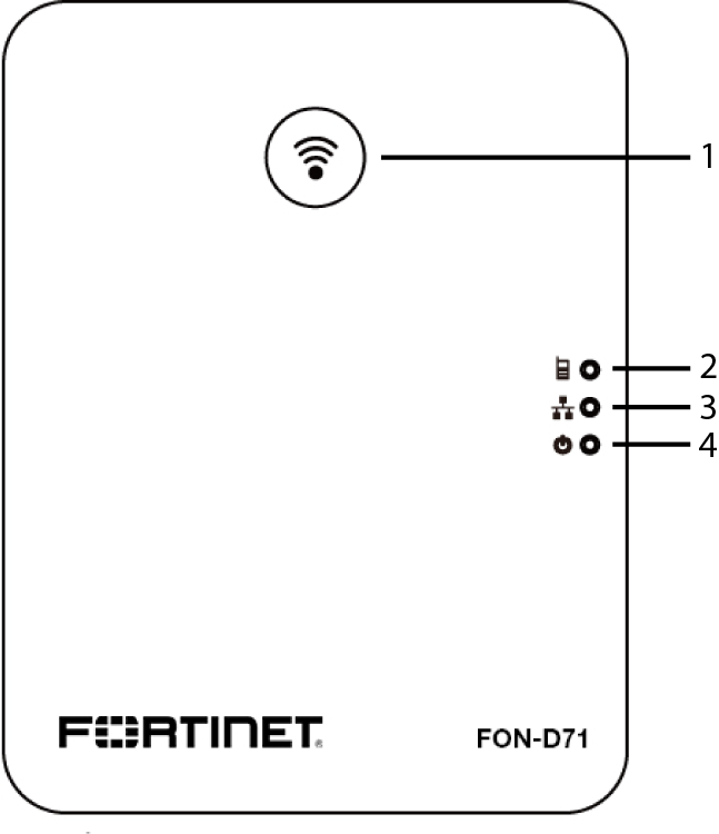

To register the FON-D71-H handset with the FON-D71-B base
No.
Item
1
Paging key
  • Locates a misplaced handset.
  • Toggles the registration mode.
  • Resets the base to factory settings.
2
Registration LED
Indicates the mode of the base station:
  • Fast flashing green — paging mode.
  • Slow flashing green — registration mode.
  • Solid green — at least one handset is registered to the base.
3
Network status LED
Indicates the network status:
  • Slow flashing green — network is unavailable.
  • Solid green — network is available.
  • Off — base station is powered off.
4
Power indicator LED
Indicates the power status of the base station:
  • Slow flashing green — firmware is updating.
  • Solid green — base station is powered on.
  1. Turn on the FON-D71-H handset.
    The handset displays Searching for the base.
  2. On the base, press and hold the Paging key until the registration LED is flashing to enter the registration mode.
    The handset discovers and registers with the base.
  3. After the registration is complete, the phone displays the handset ID (such as Handset 1).
No.
Item
1
Paging key
2
Registration LED
3
Network status LED
4
Power indicator LED
