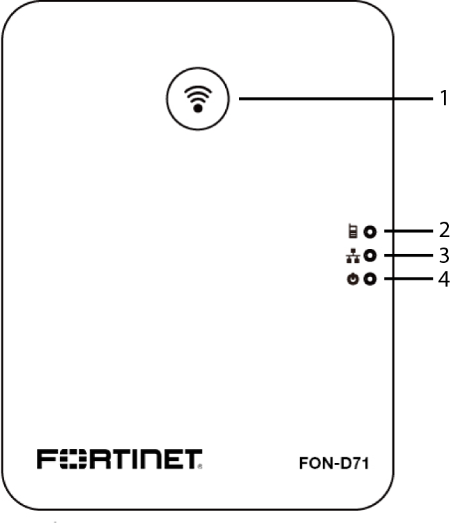

To register the FON-D71-H handset with the FON-D71-B base
No. |
Item |
Description |
1 |
Paging key |
2 |
Registration LED |
Indicates the mode of the base station:
3 |
Network status LED |
Indicates the network status:
4 |
Power indicator LED |
Indicates the power status of the base station:
- Turn on the FON-D71-H handset.
The handset displays Searching for the base.
- On the base, press and hold the Paging key until the registration LED is flashing to enter the registration mode.
The handset discovers and registers with the base.
- After the registration is complete, the phone displays the handset ID (such as Handset 1).
