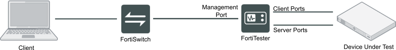

A basic network connection topology for FortiTester is shown in Figure 1.

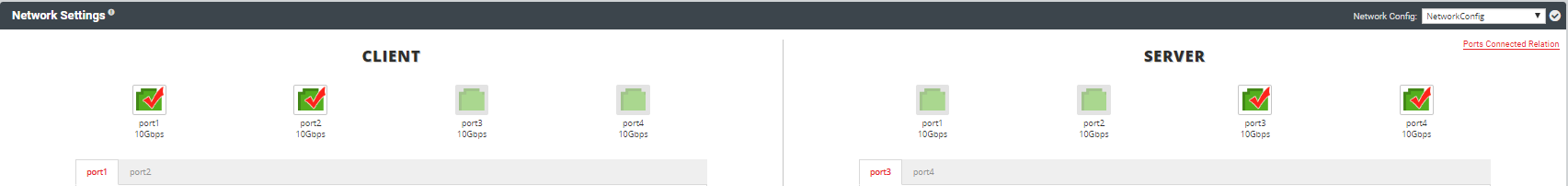

When you use one FortiTester appliance in standalone work mode, the test ports on the standalone appliance are divided between client and server. Figure 2 shows the distribution of ports in a standalone environment. Port 1, a client port, is paired with port 3, a server port; port 2, a client port, is paired with port 4, a server port.
Test ports in standalone work mode

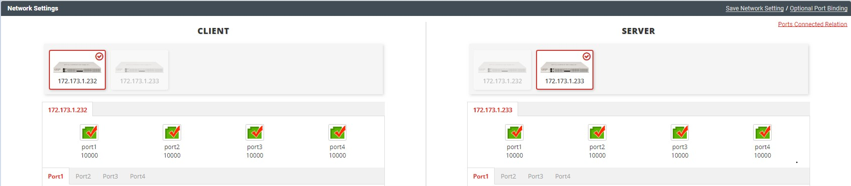

If your tests require more ports, you can join up to 4 pairs of FortiTester appliances in a Test Center. Figure 3 shows the distribution of ports in a Test Center environment with two FortiTester appliances. Ports 1-4 of the first appliance are client ports; ports 1-4 of the second appliance are server ports. Port 1 on the first appliance is paired with port 1 on the second appliance.
Test ports in Test Center / Slave work mode
For information on configuring a Test Center, see Chapter 4 - Joining multiple appliances into a Test Center.
