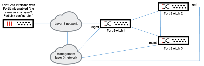

FortiLink mode over a layer-3 network
This feature allows FortiSwitch islands to operate in FortiLink mode over a layer-3 network, even though they are not directly connected to the switch-controller FortiGate unit. FortiSwitch islands contain one or more FortiSwitch units.
There are two main deployment scenarios for using FortiLink mode over a layer-3 network:
  • In-band management, which uses the FortiSwitch unitʼs internal interface to connect to the layer-3 network
  • Out-of-band management, which uses the FortiSwitch unitʼs mgmt interface to connect to the layer-3 network

Connecting additional FortiSwitch units to the first FortiSwitch unit
In this scenario, the default FortiLink-enabled port of FortiSwitch 2 is connected to FortiSwitch 1, and the two switches then form an auto-ISL. You only need to configure the discovery settings (see Step 2) for additional switches (FortiSwitch 2 in the following diagram). Check that each FortiSwitch unit can reach the FortiGate unit.
You can use the internal interface for one FortiSwitch island to connect to the layer-3 network and the mgmt interface for another FortiSwitch island to connect to the same layer-3 network. Do not mix the internal interface connection and mgmt interface connection within a single FortiSwitch island.
Other topologies
If you have a layer-2 loop topology, make certain that the alternative path can reach the FortiGate unit and that STP is enabled on the FortiLink layer-3 trunk.
If you have two FortiSwitch units separately connected to two different intermediary routers or switches and the FortiSwitch units are also connected to each other, an auto-ISL forms automatically, and STP must be enabled to avoid loops.
A single logical interface (which can be a LAG) is supported when they use the internal interface as the FortiLink management interface.
You can use a LAG connected to a single intermediary router or switch. A topology with multiple ports connected to different intermediary routers or switches is not supported.
Other topologies
