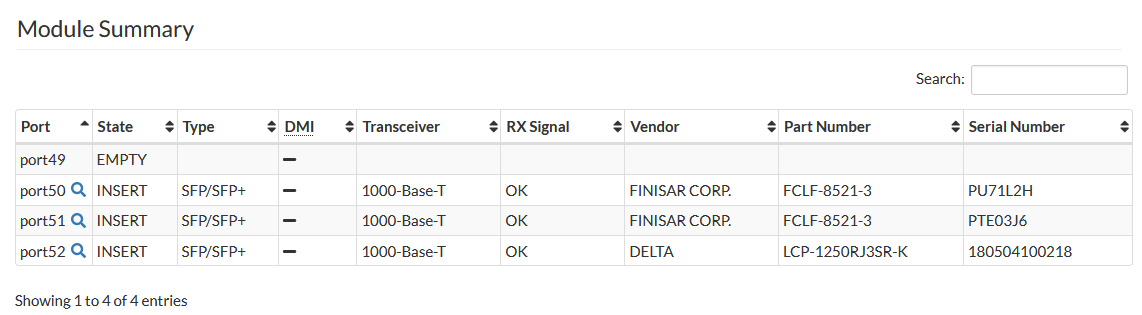

Diagnostic monitoring interface module status
With the diagnostic monitoring interface (DMI), you can view the following information
  • Module details (detail)
  • Eeprom contents (eeprom)
  • Module limits (limit)
  • Module status (status)
  • Summary information of all a port’s modules (summary)
Using the GUI:
Go to Switch > Monitor > Modules.
Using the CLI:
Use the following commands to enable or disable DMI status for the port. If you set the status to global, the port setting will match the global setting:
config switch physical-port
edit <interface>
set dmi-status {disable | enable | global}
Use the get switch modules detail/status command to display DMI information:
Using the GUI:
Using the CLI:
edit <interface>
