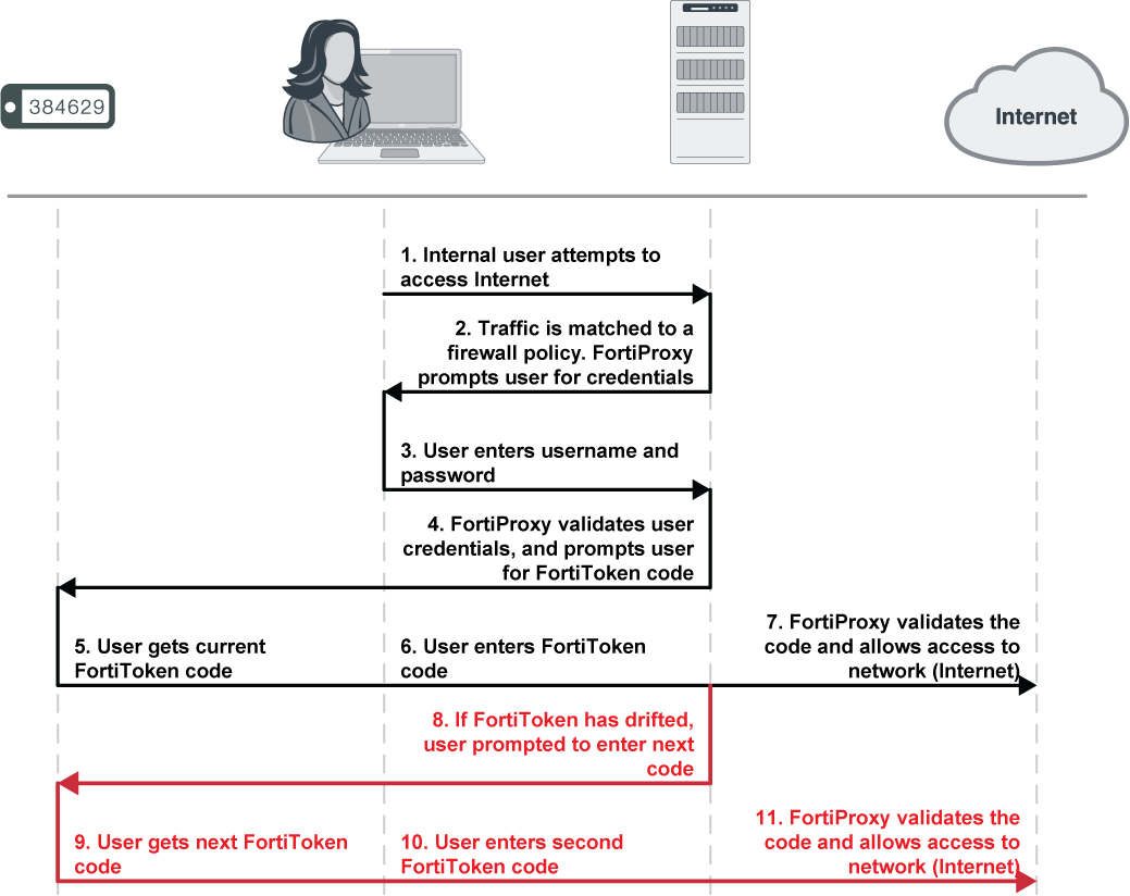

The following illustrates the FortiToken MFA process:
The user attempts to access a network resource.
FortiProxy matches the traffic to an authentication security policy and prompts the user for the username and password.
The user enters the username and password.
FortiProxy verifies their credentials. If valid, it prompts the user for the FortiToken code.
The user views the current code on their FortiToken and enters the code at the prompt.
FortiProxy verifies the FortiToken code. If valid, it allows the user access to network resources.
If the FortiToken has drifted, the following must take place for the FortiToken to resynchronize with FortiProxy:
FortiProxy prompts the user to enter a second code to confirm.
The user gets the next code from the FortiToken and enters the code at the prompt.
FortiProxy uses both codes to update its clock to match the FortiToken.
