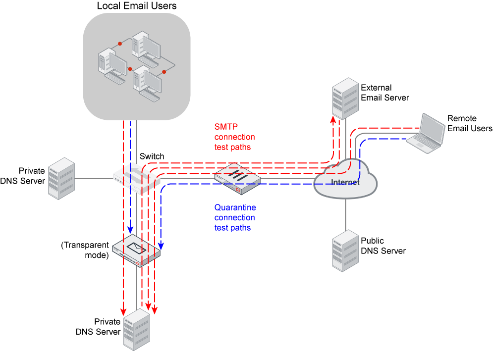

Connection test paths (gateway mode)

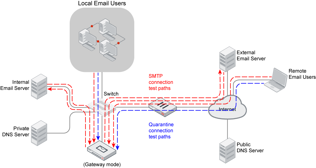

Connection test paths (transparent mode)

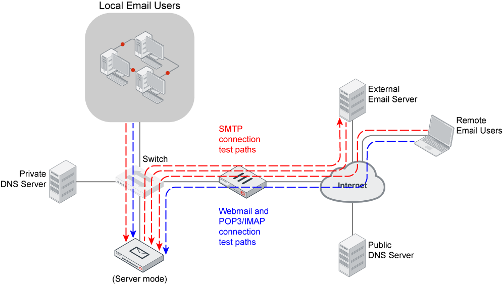

Connection test paths (server mode)
To verify all SMTP connections to and from your FortiMail unit, consider both internal and external recipient email addresses, as well as all possible internal and external SMTP clients and servers that will interact with your FortiMail unit, and send email messages that test the connections both to and from each of those clients and servers. For example:

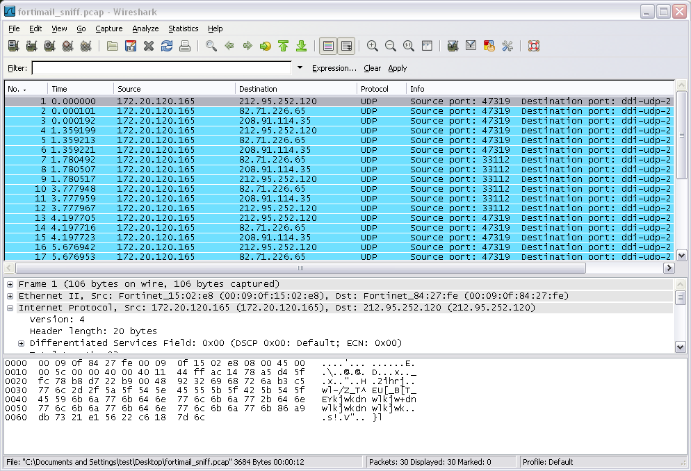

Instead of reading packet capture output directly in your CLI display, you usually should save the output to a plain text file using your CLI client. Saving the output provides several advantages. Packets can arrive more rapidly than you may be able to read them in the buffer of your CLI display, and many protocols transfer data using encodings other than US-ASCII. It is usually preferable to analyze the output by loading it into in a network protocol analyzer application such as Wireshark.
For example, you could use PuTTY or Microsoft HyperTerminal to save the sniffer output. Methods may vary. See the documentation for your CLI client.
Requirements
- terminal emulation software such as PuTTY
- a plain text editor such as Notepad
- a Perlinterpreter
- network protocol analyzer software such as Wireshark

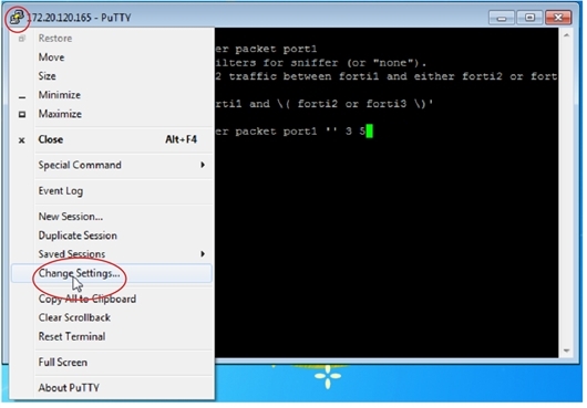

To view packet capture output using PuTTY and Wireshark
- On your management computer, start PuTTY.
- Use PuTTY to connect to the FortiMail appliance using either a local serial console, SSH, or Telnet connection. For details, see the FortiMail CLI Reference.
- Type the packet capture command, such as:
- In the upper left corner of the window, click the PuTTY icon to open its dropdown menu, then select Change Settings.
- In the Category tree on the left, go to Session > Logging.
- In Session logging, select Printable output.
- In Log file name, click the Browse button, then choose a directory path and file name such as
C:\Users\MyAccount\packet_capture.txtto save the packet capture to a plain text file (you do not need to save it with the.logfile extension). - Click Apply.
- Press Enter to send the CLI command to the FortiMail unit, beginning packet capture.
- If you have not specified a number of packets to capture, when you have captured all packets that you want to analyze, press Ctrl + C to stop the capture.
- Close the PuTTY window.

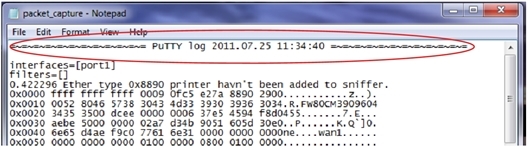

- Open the packet capture file using a plain text editor such as Notepad.
- Delete the first and last lines, which look like this:

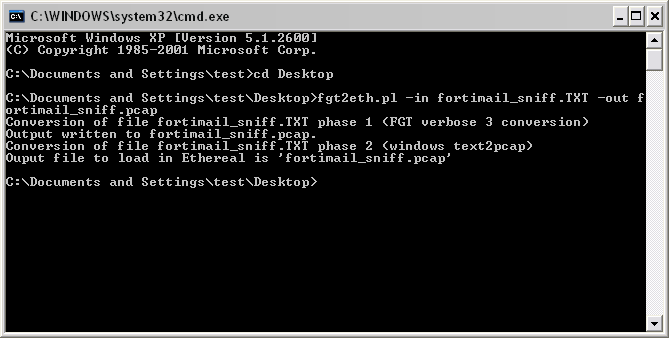

- Convert the plain text file to a format recognizable by your network protocol analyzer application.

A dialog appears where you can configure PuTTY to save output to a plain text file.
=~=~=~=~=~=~=~=~=~=~=~= PuTTY log 2011.07.25 11:34:40 =~=~=~=~=~=~=~=~=~=~=~=
FortiMail-2000 #
These lines are a PuTTY timestamp and a command prompt, which are not part of the packet capture. If you do not delete them, they could interfere with the script in the next step.
You can convert the plain text file to a format (.pcap) recognizable by Wireshark (formerly called Ethereal) using the fgt2eth.pl Perl script.
The fgt2eth.pl script is provided as-is, without any implied warranty or technical support, and requires that you first install a Perl module compatible with your operating system. |
To use fgt2eth.pl, open a command prompt, then enter a command such as the following:
Methods to open a command prompt vary by operating system. On Windows 10, click Start (Windows logo) then enter |
fgt2eth.pl -in packet_capture.txt -out packet_capture.pcap
where:
fgt2eth.plis the name of the conversion script; include the path relative to the current directory, which is indicated by the command promptpacket_capture.txtis the name of the packet capture’s output file; include the directory path relative to your current directorypacket_capture.pcapis the name of the conversion script’s output file; include the directory path relative to your current directory where you want the converted output to be saved
Converting sniffer output to .pcap format
Viewing sniffer output in Wireshark
