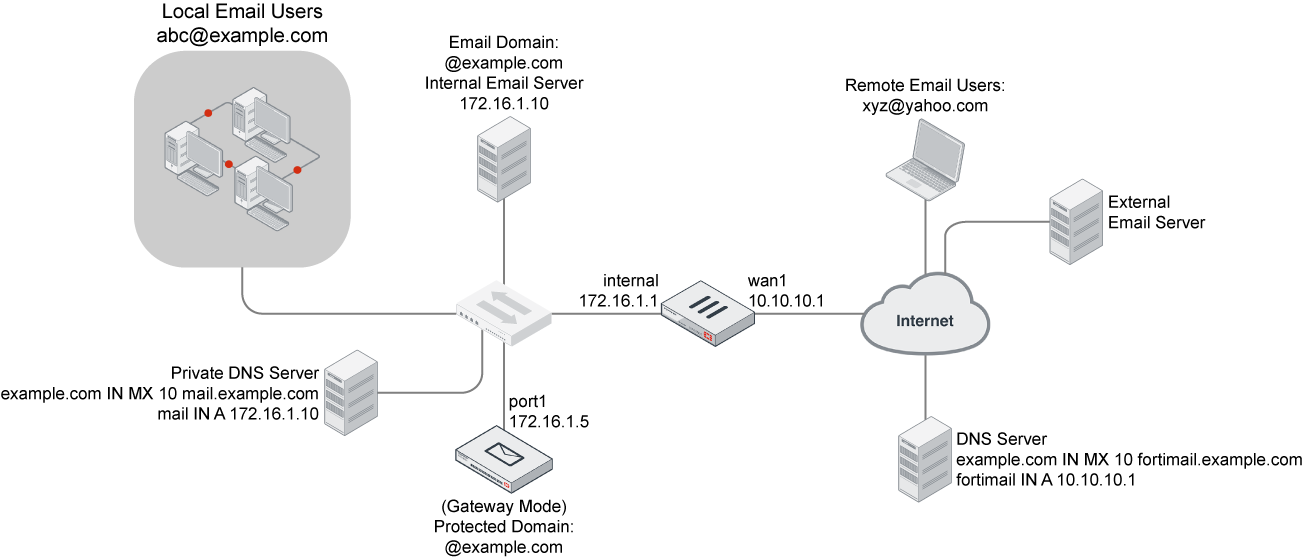

Characteristics of gateway mode
When operating in gateway mode, the FortiMail unit acts as a mail transfer agent (MTA), sometimes known as an email gateway or relay. The FortiMail unit receives email messages, scans for viruses and spam, then relays email to its destination email server for delivery. External MTAs connect to the FortiMail unit, rather than directly to the protected email server.
FortiMail units operating in gateway mode provide a web-based user interface from which email users can access personal preferences and their per-recipient quarantined email. However, FortiMail units operating in gateway mode do not locally host mailboxes such as each email user’s inbox. Mailboxes are stored on the protected email servers.
Gateway mode requires some changes to an existing network. Requirements include MX records on public DNS servers for each protected domain, which must refer to the FortiMail unit instead of the protected email servers. You may also need to configure firewalls or routers to direct SMTP traffic to the FortiMail unit rather than your email servers.
Example gateway mode topology
For example, an Internet service provider (ISP) could deploy a FortiMail unit to protect their customers’ email servers. For security reasons, customers do not want their email servers to be directly visible to external MTAs. Therefore, the ISP installs the FortiMail unit in gateway mode, and configures its network such that all email traffic must pass through the FortiMail unit before reaching customers’ email servers.
For sample deployment scenarios, see Gateway mode deployment.

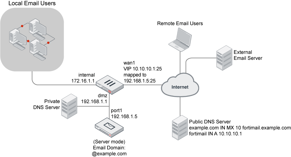

Characteristics of transparent mode
When operating in transparent mode, the FortiMail acts as either an implicit relay or a proxy. The FortiMail unit intercepts email messages, scans for viruses and spam, then transmits email to its destination email server for delivery. External MTAs connect through the FortiMail unit to the protected email server.
Transparency at both the network and application layers is configurable, but not required. When hiding, the FortiMail unit preserves the IP address and domain name of the SMTP client in IP headers and the SMTP envelope and message headers, rather than replacing them with its own.
FortiMail units operating in transparent mode provide a web-based user interface from which email users can access personal preferences and email quarantined to their per-recipient quarantine. However, FortiMail units operating in transparent mode do not locally host mailboxes such as each email user’s inbox. These mailboxes are stored on the protected email servers.
By default, FortiMail units operating in transparent mode are configured as a bridge, with all network interfaces on the same subnet. You can configure out-of-bridge network interfaces if you require them, such as if you have some protected email servers that are not located on the same subnet. If you set an interface to route mode, you must assign the interface a local IP address that belongs to a different subnet from that of the management IP.
Port 1 is the only port permanently attached to the built-in bridge and thus cannot be set in route mode.
Transparent mode usually requires no changes to an existing network. Requirements include that the FortiMail unit must be physically inline between the protected email server and all SMTP clients—unlike gateway mode. Because FortiMail units operating in transparent mode are invisible, clients cannot be configured to route email directly to the FortiMail unit; so, it must be physically placed where it can intercept the connection.
Example transparent mode topology
Do not connect two ports to the same VLAN on a switch or the same hub. Some Layer 2 switches become unstable when they detect the same media access control (MAC) address originating on more than one network interface on the switch, or from more than one VLAN.
For example, a school might want to install a FortiMail unit to protect its mail server, but does not want to make any changes to its existing DNS and SMTP client configurations or other network topology. Therefore, the school installs the FortiMail unit in transparent mode.
For sample deployment scenarios, see Transparent mode deployment.
