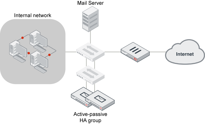

Active-passive HA group operating in gateway mode
Config-only HA group operating in gateway mode
If the config-only HA group is installed behind a load balancer, the load balancer stops sending email to failed FortiMail units. All sessions being processed by the failed FortiMail unit must be restarted and will be re-directed by the load balancer to other FortiMail units in the config-only HA group.
You can mix different FortiMail models in the same HA group. However, all units in the HA group must have the same firmware version.
When mixing FortiMail models, the HA group is limited by the capacity and configuration limits of the least powerful model.

    Example: Active-passive HA group in gateway mode
    In this example, two FortiMail-400 units are configured to operate in gateway mode as an active-passive HA group.
    The procedures in this example describe HA configuration necessary to achieve this scenario. Before beginning, verify that both of the FortiMail units are already:
    Virtual IP address for HA failover
    The active-passive HA group is located on a private network with email users and the protected email server. All are behind a FortiGate unit which separates the private network from the Internet. The DNS server, remote email users, and external SMTP servers are located on the Internet.
    For both FortiMail units:
    port1
    • connected to a switch which is connected only to the computer that the FortiMail administrator uses to manage the HA group
    • administrative access occurs through this port
    port3
    • connected to a switch which is connected to the private network and, indirectly, the Internet
    • email connections occur through this port
    port6
    • connected directly to each other using a crossover cable
    • heartbeat and synchronization occurs through this port
    The secondary unit will become the new primary unit when a failover occurs. In order for it to receive the connections formerly destined for the failed primary unit, the new primary unit must adopt the failed primary unit’s IP address. You will configure an HA virtual IP address on port3 for this purpose.
    While the configured primary unit is functional, the HA virtual IP address is associated with its port3 network interface, which receives email connections. After a failover, the HA virtual IP address becomes associated with the new primary unit’s port3. As a result, after a failover, the new primary unit (originally the secondary unit) will then receive and process the email connections.
    This example contains the following topics:

    Similarly, for the HA group, DNS A records should target the IP address of the port3 interface of the primary FortiMail-400 unit. Additionally, administrators should administer each FortiMail unit in the HA group by connecting to the IP address of each FortiMail unit’s port1.
    If a failover occurs, the network must be able to direct traffic to port3 of the secondary unit without reconfiguring the DNS A record target. The secondary unit must cleanly and automatically substitute for the primary unit, as if they were a single, standalone unit.
    Unlike the configuration of the standalone unit, for the HA group to accomplish that substitution, all email connections must use an IP address that transfers between the primary unit and the secondary unit according to which is currently the primary unit. This transferable IP address can be accomplished by configuring the HA group to either:
    • set the IP address of the current primary unit’s network interface
    • add a virtual IP address to the current primary unit’s network interface
    In this example, the HA group uses the method of adding a virtual IP address. Email connections will not use the actual IP address of port3. Instead, all email connections will use only the virtual IP address 172.16.1.2, which is used by port3 of whichever FortiMail unit’s effective HA operating mode is currently primary. During normal HA group operation, this IP address resides on the primary unit. Conversely, after a failover occurs, this IP address resides on the former secondary unit (now the current primary unit).
    Also unlike the configuration of the standalone unit, both port5 and port6 are configured for each member of the HA group. The primary unit’s port5 is directly connected using a crossover cable to the secondary unit’s port5; the primary unit’s port6 is directly connected to the secondary unit’s port6. These links are used solely for heartbeat and synchronization traffic between members of the HA group.
    For comparison with the standalone unit, examine the network configuration of the primary unit in the following table.
    Example: Failover scenarios
    This section describes basic FortiMail active-passive HA failover scenarios. For each scenario, refer to the HA group shown in the following figure. To simplify the descriptions of these scenarios, the following abbreviations are used:
    • P1 is the configured primary unit.
    • S2 is the configured secondary unit.
    Example active-passive HA group
    This section contains the following HA failover scenarios:
    port1
    port3
    port6

    Administering an HA group
    In most cases, you will an HA group by connecting to the primary unit as if it were a standalone unit.
    Management tasks performed on each HA group member
    Connect to...
    For...
    Primary unit
    (192.168.1.5)
    • synchronized configuration items, such as antispam settings
    • primary unit HA management tasks, such as viewing its effective HA operating mode and configuring its HA mode and Shared password
    • viewing the log messages of the primary unit
    Secondary unit
    (192.168.1.6)
    • secondary unit HA management tasks, such as viewing its effective HA operating mode and configuring its HA mode and Shared password
    • viewing the log messages of the secondary unit
    If the initial configuration synchronization fails, such as if it is disrupted or the network cable is loose, you should manually trigger synchronization after changing the configuration of the primary unit. For information on manually triggering configuration synchronization, see Using high availability (HA).
    Some parts of the configuration are not synchronized, and must be configured separately on each member of the HA group. For details, see Configuration settings that are not synchronized.
