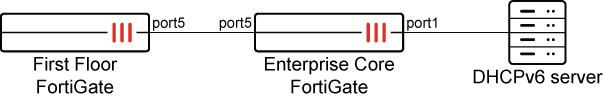

In this example, the Enterprise Core FortiGate is connected to a DHCPv6 server provided by the ISP through an upstream interface (port1). The Enterprise Core FortiGate is configured with a delegate interface (port5) to receive the IPv6 prefix and DNS server address from the upstream interface.
A downstream interface (port5) connects the First Floor FortiGate to the Enterprise Core FortiGate. The First Floor FortiGate interface (port5) is configured to receive the IPv6 address and DNS server address from the Enterprise Core FortiGate using DHCP addressing mode or auto-configuration.

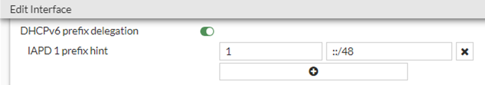

Configure the upstream interface on Enterprise Core FortiGate:
Go to Network > Interfaces and edit port1.
Enable DHCPv6 prefix delegation.
Select the + in the IAPD prefix hint to open the ID and prefix field.
Enter 1 for ID and ::/48 for prefix field. You can add two or more entries. Select the x icon in the field to remove an entry.
Click OK.
Verify that the upstream interface obtained the prefix delegation, see Verify upstream interface obtained prefix delegation and DNS server address.
