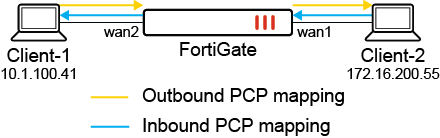

The following topology is used to demonstrate two use cases of PCP mapping: with SNAT and DNAT.
Example 1: PCP mapping with SNAT
This example demonstrates how PCP mapping works with SNAT. In the FortiGate PCP server settings, the pcp-pool1 pool is applied in the firewall policy with pcp-outbound mode. A PCP request is sent from Client-1 to the FortiGate to create PCP outbound mapping. When traffic is sent from Client-1 to Client-2, SNAT is performed by the PCP outbound mapping.

To verify the configuration:
  1. Generate a PCP peer request from Client-1 (10.1.100.41) to the FortiGate.
  2. Verify the client's PCP request to the PCP server. In this example, an PCP client was installed on Ubuntu:
    root@pc41:~# pcp -i 10.1.100.41:41111 -p 172.16.200.55:80 -s 10.1.100.8
  3. On the FortiGate, verify the PCP outbound mappings list:

Example 2: PCP mapping with DNAT
This example demonstrates how PCP mapping works with DNAT. In the FortiGate PCP server settings, the pcp-pool1 pool is applied in the firewall policy with pcp-inbound mode. A PCP request is sent from Client-1 to the FortiGate to create PCP inbound mapping. When traffic is sent from Client-2 to access the external IP of Client-1 (172.16.200.231:50000), traffic passes by due to the PCP inbound mapping.
    root@pc41:~# pcp -i 10.1.100.41:80 -s 10.1.100.8
