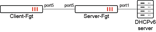

IPv6 prefix delegation allows the dynamic assignment of an address prefix and DNS server address to an upstream interface. An upstream interface is typically the interface that is connected to an Internet Service Provider (ISP). This process also automates the assignment of prefixes to downstream interfaces. A downstream interface is any interface that is not an upstream interface and uses delegated addressing mode. Downstream interfaces can be configured to request specific IPv6 subnets from the upstream interface. Once a downstream interface receives the IPv6 address, other devices connected to the downstream interface can obtain an IPv6 address by using DHCPv6 or by configuring their own IP address using auto-configuration.
In this example, Server-Fgt is connected to a DHCPv6 server provided by the ISP through an upstream interface (port1). Server-Fgt is configured with a delegate interface (port5) to receive the IPv6 prefix and DNS server address from the upstream interface.
A downstream interface (port5) connects Client-Fgt to Server-Fgt. The Client-Fgt interface (port5) is configured to receive the IPv6 address and DNS server address from the Server-FortiGate using DHCP addressing mode or auto-configuration.
Using the GUI or CLI to configure a downstream FortiGate to obtain the IPv6 and DNS server address from delegated interface using DHCP mode requires the following steps:

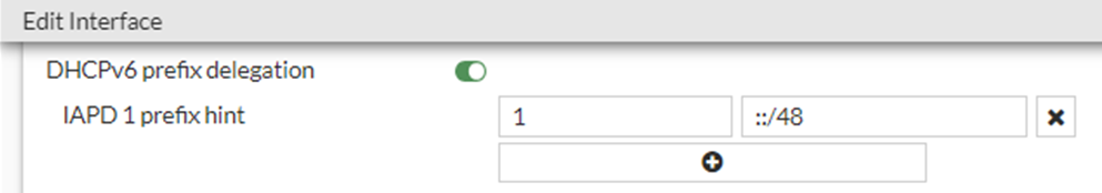

  1. Configure the upstream interface on Server-Fgt:
    1. Go to Network > Interfaces and edit the port1.
    2. Enable DHCPv6 prefix delegation.
    3. Select the + in the IAPD prefix hint to open the ID and prefix field.
    4. Enter 1 for ID and ::/48 for prefix field. You can add two or more entries. Select the x icon in the field to remove an entry.
    5. Click OK.

To configure Client_FGT:
  1. Configure Client-Fgt interface using auto-configure:
    config system interface edit "port5" config ipv6 set autoconf enable end next end
  2. Verify Client-Fgt automatically generated an IPv6 address and obtained the DNS server address from the delegated interface:
    # diagnose ipv6 address list | grep port5 dev=4 devname=port5 flag= scope=0 prefix=64 addr=2000:db8:d0c:1:20c:29ff:fe4d:f847 preferred=4294967295 valid=4294967295 cstamp=17203697 tstamp=17225377
FortiGate can send DNS server addresses using Router Advertisement (RA), which allows any device that is capable of receiving DNS server addresses by using RA to obtain DNS server addresses.
Additionally, FortiGate can receive DNS server addresses through the use of SLAAC with a DHCPv6 stateless server, even though it is currently unable to receive DNS server addresses using RA due to RFC 4862 implementation. See SLAAC with DHCPv6 stateless server for more information.
