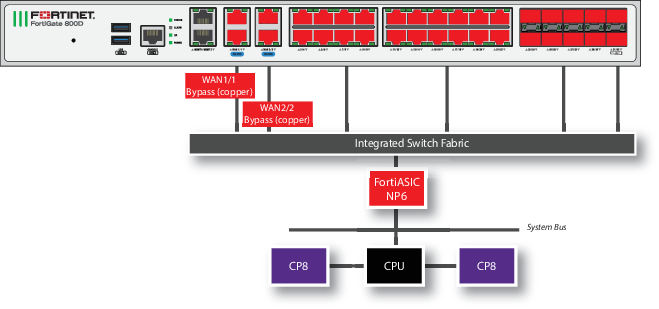

FortiGate 800D fast path architecture
The FortiGate 800D includes one NP6 processor connected through an integrated switch fabric to all of the FortiGate 800D network interfaces. This hardware configuration supports NP6-accelerated fast path offloading for sessions between any of the FortiGate 800D interfaces.
The FortiGate 800D features the following front panel interfaces:
  • Two 10/100/1000BASE-T Copper (MGMT1 and MGMT2, not connected to the NP6 processors)
  • Two 10/100/1000BASE-T Copper bypass pairs (WAN1 and 1 and WAN2 and 2)
  • Eighteen 10/100/1000BASE-T Copper (3 to 22)
  • Eight 1 GigE SFP (23 to 30)
  • Two 10 GigE SFP+ (31 and 32)
