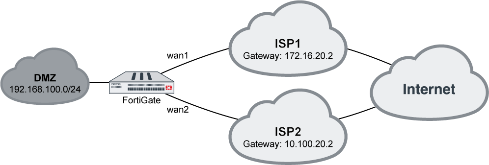

In this example, your wan1 and wan2 SD-WAN interfaces connect to two ISPs that both go to the public internet. The cost of wan2 is less than that of wan1. You want to configure Gmail services to use the lowest cost interface, but the link quality must meet a standard of latency: 10ms, and jitter: 5ms.

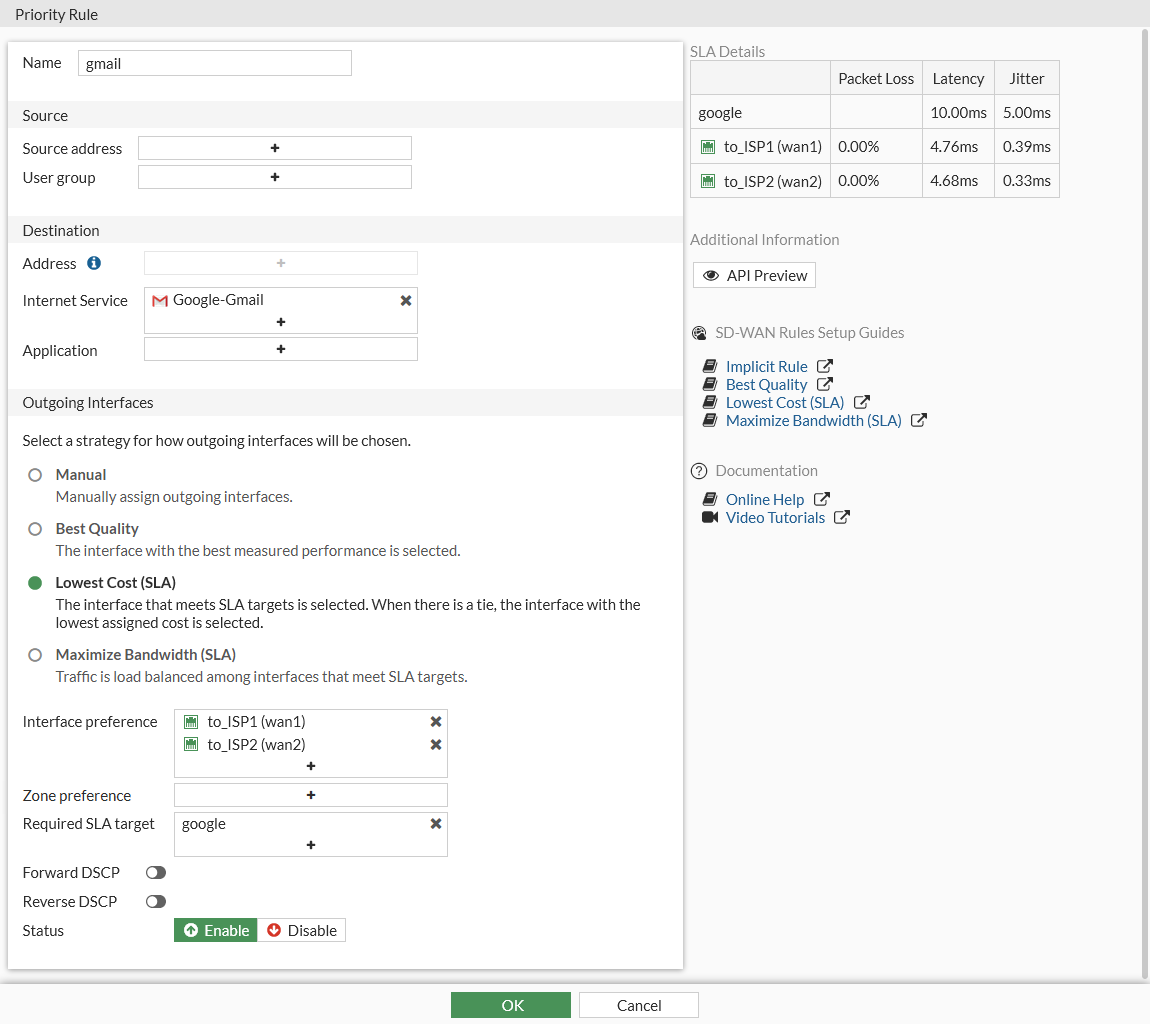

  6. Go to Network > SD-WAN, select the SD-WAN Rules tab, and click Create New.
  7. Enter a name for the rule, such as gmail.
  8. Configure the following settings:
    Internet Service
    Google-Gmail
    Strategy
    Lowest Cost (SLA)
    Interface preference
    wan1 and wan2
    Required SLA target
    google
  9. Click OK.
    Internet Service
    Google-Gmail
    Strategy
    Lowest Cost (SLA)
    wan1 and wan2
    Required SLA target
    google
  9. Click OK.
