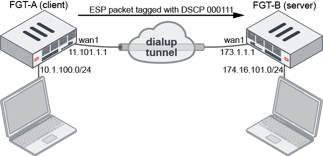

Configure DSCP for IPsec tunnels
Configuring the differentiated services (DiffServ) code in phase2 of an IPsec tunnel allows the tag to be applied to the Encapsulating Security Payload (ESP) packet.
  • If diffserv is disabled in the IPsec phase2 configuration, then the ESP packets' DSCP value is copied from the inner IP packet DSCP.
  • If diffserv is enabled in the IPsec phase2 configuration, then ESP packets' DSCP value is set to the configured value.
Offloading traffic to the NPU must be disabled for the tunnel.
In this example, NPU offloading is disabled, diffserv is enabled, and the diffserv code is set to 000111 on FGT-A. Only one side of the tunnel needs to have diffserv enabled.
