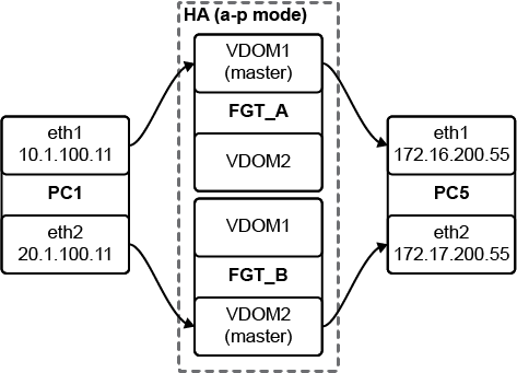

The following is an example topology and scenario:
In this example, FGT_A and FGT_B are in HA a-p mode with two virtual clusters. Two primaries exist on different FortiGate units. PC1 eth1 can access PC5 eth1 through VDOM1, and PC1 eth2 can access PC5 eth2 through VDOM2.
On PC5, to listen for an SCTP connection:
sctp_darn -H 172.16.200.55 -B 172.17.200.55 -P 2500 -l
On PC1, to start an SCTP connection:
sctp_darn -H 10.1.100.11 -B 20.1.100.11 -P 2600 -c 172.16.200.55 -c 172.17.200.55 -p 2500 -s
An SCTP four-way handshake is on one VDOM, and a session is created on that VDOM. With the default configuration, there is no session on any other VDOM, and the heartbeat on another path (another VDOM) is dropped. After enabling sctp-session-without-init, the other VDOM creates the session when it receives the heartbeat, and the heartbeat is forwarded:
