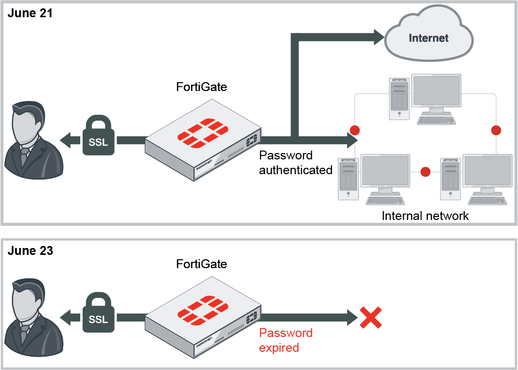

SSL VPN with local user password policy
This is a sample configuration of SSL VPN for users with passwords that expire after two days. Users are warned after one day about the password expiring. The password policy can be applied to any local user password. The password policy cannot be applied to a user group or a local remote user such as LDAP/RADIUS/TACACS+.
In FortiOS 6.2, users are warned after one day about the password expiring and have one day to renew it. If the password expires, the user cannot renew the password and must contact the administrator for assistance.
In FortiOS 6.0/5.6, users are warned after one day about the password expiring and have to renew it. If the password expires, the user can still renew the password.
Sample topology
Sample configuration

    When the warning time is reached, the user is prompted to enter a new password.
    In FortiOS 6.2, when the password expires, the user cannot renew the password and must contact the administrator.
    In FortiOS 6.0/5.6, when the password expires, the user can still renew the password.
